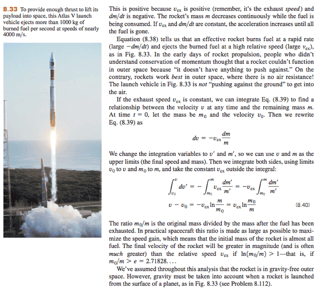

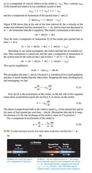

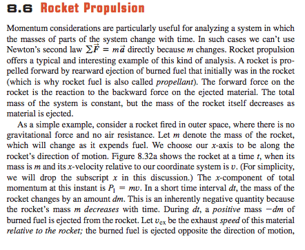

hi all,
i've been confused about what the difference is between fuel velocity and exhaust velocity. apparently, fuel velocity is equal to rocket velocity minus exhaust velocity. attached are screenshots of the textbook reading that confused me. if anyone can explain this section to me, i would greatly appreciate it!
thanks!
joe
Screen Shot 2012-07-05 at 3.37.08 PM.png   Screen Shot 2012-07-05 at 3.37.33 PM.png   Screen Shot 2012-07-05 at 3.37.46 PM.png

hi joe! welcome to pf!
Quote by liddojoe View Post
fuel velocity, vfuel, is the velocity of the fuel (relative to earth)
exhaust velocity, vex, is the velocity of the fuel relative to the rocket
vex is constant (because the rocket engine has constant power)
