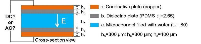

First, I’d like to say that this is not homework, but my research work. I’ll be very appreciated if someone could help me to address this issue, many thanks in advance.
My experimental purpose is to generate uniform electric field inside microchannel by externally-applied electric field. (“externally” here means no direct contact between electrodes and water)
But there is a questionable point still killing me. As I know, in pure water, autoionization of water molecules can generate hydroxide and hydronium ions at a constant concentration, and these free ions can form Debye space charge layers that screen electric fields. Does it mean, no matter how high DC V is (like 1 KV), the final electric field intensity inside microchannel would go to zero after instantaneous screening process?
If the above statement is valid, then I apply alternating current voltage, like sinusoidal AC (100 kHz, peak voltages from 0 and 500 V) instead of DC, I wonder how to calculate electric field intensity inside microchannel? Taken the rate of electrostatic screening into account, what the minimal frequency of ac should I set ?
Many thanks again for your attention to this matter.

I once used the following equations to calculate Ec, the initial electric field inside microchannel ("initial" here means before induced electric field formation by OH- and H3O+ ions in water );
U=2Eb + Ec (Eq.1)
Eb/Ec=εc/εb (Eq.2) (electric field is inversely proportional to dielectric constant)
The results of Eb and Ec are 1630 kv/m, 54 kv/m respectively, in the case of U = 1000 V.
Is this solving method correst?

Aug7-12, 01:19 PM   #7
Voltage is field strength times distance. Thats why the unit for E is V/m.
V/m * m = V
So U = 2*Eb*hb + Ec*hc
The water is conductive.
In a static setup - i.e. when no current is flowing and all charges are static - the inside of a conductor is always free of any electric field. When you turn on a DC voltage source you get a current flowing for a tiny fraction of a second and then it stops and the field inside the water has disappeared. How quickly the field in the water disappeares depends again on the capacity and the resistance. The capacity is Cb/2, where Cb is the capacity of a dielectric plate You effectively have 2 capacitors and a conductor in series.
With that you can calculate the time constant.
http://en.wikipedia.org/wiki/RC_time_constant
τ = R*C
The time constant is the time in seconds that it takes to fill a capacitor to 63%
Diffusion plays no role here except maybe if your dielectric plates are not perfectly watertight and allow ions to pass through.
To get a constant field inside the water with DC you need to let a constant current flow through the water. That means the water needs to have direct contact with the metal. The more pure the water the higher it's resistance and the less current you need.

Diffusion leads to a non-zero Debye length, and this can lead to electric fields even in the static case. The concentration gradient of the ions leads to an effective force against the electric field.
@0lolol0: Hmm, could be. Pure water has a low concentration of OH- and H3O+, which should give some larger value for the Debye length. But probably not 400µm.
So the main question now is the time-scale of this.
