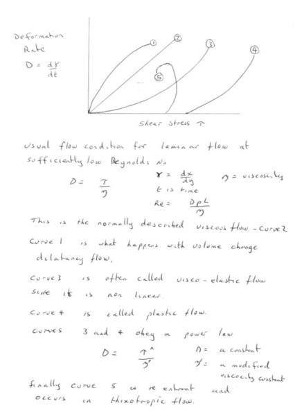

Solid/Fluid Mechanics
Whilst I appreciate you may wish to preserve confidentiality in your work, you need to provide more context for proper comment to be offered.
This, however, is an area of knowledge that is wide open for much fruitful research.
Here are some thoughts.
Two parameters of importance in flow mechanics are distance and time.
In gas dynamics and hydraulics distances are large and timescales are short in relation to the size of the fluid element or parcel. Fluids usually travel quite a long way in a relatively short time.
In plastic flow it is the other way round. Fluid elements do not move very far from their start point and often take a very long time to do this even to geological timescales.
I can only think of one exception which is in the field of viscous damping.
I have supplied some context of my own in the attachment, but please let us know if you are talking about contact mechanics, rheological rock mechanics, asphalt machanics, viscous damping or what.
Feel free to use the PM system.

Finally remember also that Reynolds Number division into laminar and turbulent is strictly only valid for Newtonian fluids type 2 on my sketch.
Come back if you have any further questions.
