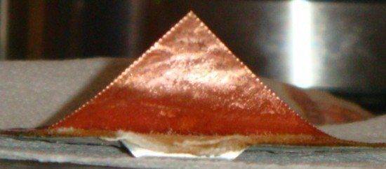

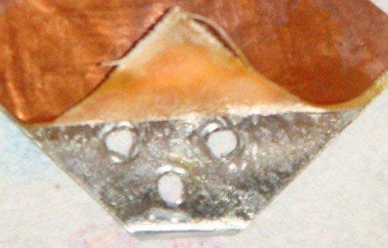

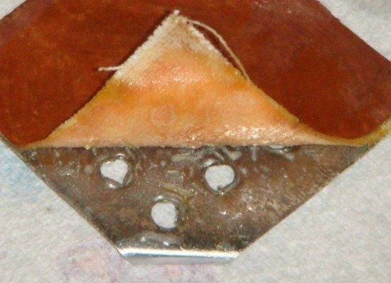

hi NascentOxygen
i'm hoping that i will have successfully attached some photos to this post!
i removed a cell from its load and peeled back the corner of the layers to take the photos
apologies for the quality - firstly that the focus is not great at close-up; secondly, it was difficult to get a good single photo of the zinc electrode, due to reflection from its surface
i've taken two shots of the zinc:
- one (more in focus) gives a reasonable idea of the condition of the separator layer and the honey residue on the zinc (but the zinc surface is reflecting the peeled back translucent separator above it which is coloured by the copper electrode behind);
- the other (less in focus) is taken more from above and hopefully gives a better impression of the surface colour of the zinc, although there is still a certain amount of reflection nearer the corner (of the background above the cell)
the cell was constructed early July 2011 and was connected to a load continuously for 7 months; it was then disconnected for 5 months and had been re-connected to the load continuously for approximately a month prior to these photos being taken today
i hope this provides an answer to your "telling point" regarding the condition of the metal surfaces and the fabric
i also hope that someone on the forum will be able to provide an answer to my second question!
thanks for reading
The pics are interesting. It looks like you have enough zinc there for a couple of D cells, so it's not surprising they aren't showing much wear and tear. Did you polish the zinc foil to make it shiny when you bought it, or was it already shiny when purchased?
You see no difference from when the metals were new? Is there no pitting of the zinc, no white powder anywhere, not even any dulling of its lustre? With dissimilar metals, it's a case of the zinc dissolving to protect the copper (zinc providing a "sacrificial anode").

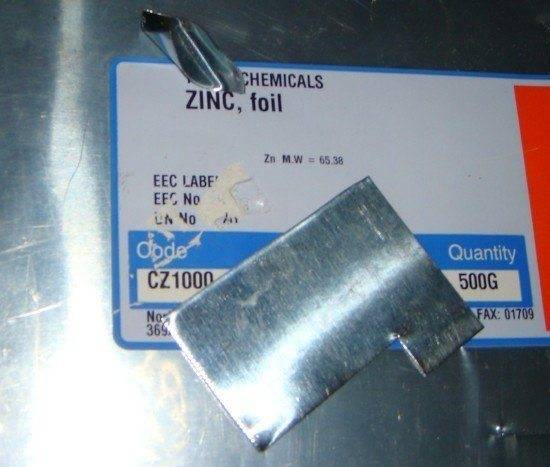

i don't believe that i needed to polish the zinc material prior to assembling a cell; I've washed the electrodes with a little detergent and kitchen roll paper to remove any grease (to reduce possibility of subsequent corrosion caused by handling when i cut the foil)
i'm hoping to attach a photo of the zinc foil material, as received, so you can get an idea of its initial state

i notice from my photos posted for you last night that the copper electrode now looks shinier (and with a more even finish, eg., no indication of 'brushing') than that produced by my initial cleaning>> "You see no difference from when the metals were new? Is there no pitting of the zinc, no white powder anywhere, not even any dulling of its lustre?"
In the photos i posted last night (of a zinc electrode after 7 months continuous use, 8 months total use) the surface appears shiny, with no evidence of any white powder (the honey which I've used has a milky-white colouring, but the 'blobs' of it on the electrode don't appear to contain any 'sediment')
i couldn't detect any pitting; if anything, the surface looked slightly shinier than the material as delivered (but maybe no shinier than after I've washed it?)>> "Can you post the circuit diagram of what you are using?"
