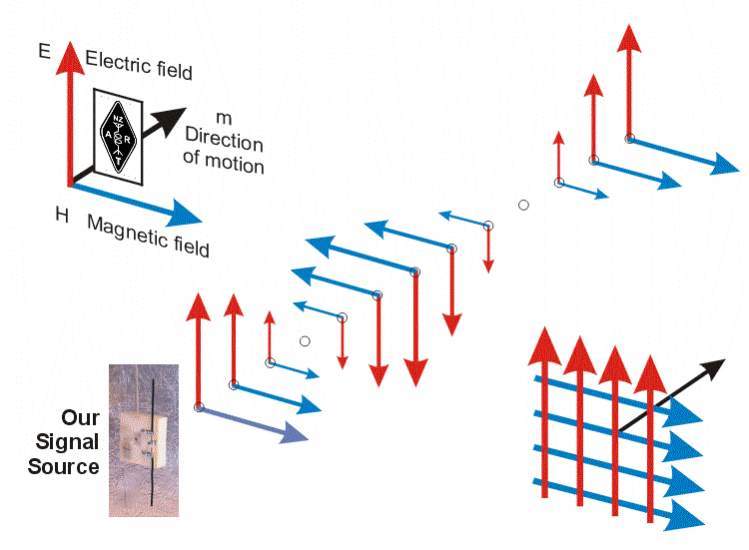

OK, that leads us to the next stage. for a start dont get so wrapped up by this sine wave thing :)
An E-M field is made up of 2 separate fields and as you may guess they are an Electric field and a Magnetic field. These 2 fields are perpendicular to each other.
Thanks to the NZART for the graphic :)

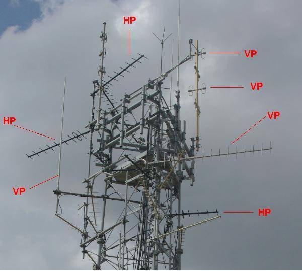

You may have noticed as you look around that you see antennas orientated in one of normally two different polarisations, horizontal and vertical.
If the transmitting antenna is vertically polarised so will the receiving antenna. If the transmitting antenna was say, vertical and the receiving antenna horizontal, there would be a substantial reduction in the received signal strength because of the mismatch.
Above is a pic of a local radio tower site, you can see there are a mass of antennas on it, and this was only the top 1/3 of the tower
I have marked some of the antennas VP or HP to show you which ones are Vertically Polarised or Horizontally Polarised.
You can see that they are all pointing in various directions. All point to another antenna at the other end of the link which will have the same polarisation.
cheers
Dave

There's one that says VP and it seems to be HP to me. I notice that the VP antennas point up to the sky but in space there's no up. I'm learning so much but I don't know what I could do in return for helping me so much. [QUOTE=davenn;4064872]OK back to antennas and angles and things.....
which one are you referring to ? Maybe that vertical antenna on the left side of the mast ?
OK I will go through the antennas I have labelled ... from left to right....
1 -- a 9 element horizontally polarised Yagi
2 -- a vertically polarised colinear
3 -- a 9 element horizontally polarised Yagi ( one centre top)
then down the right hand side from top to bottom....
4 -- a vertically polarised dipole
5 -- a vertically polarised dipole
6 -- a 15 element vertically polarisd Yagi
7 -- 2 x horizontally polarised Yagis ( line is pointing to 2 antennas at the bottom)
Now I have introduced some new terms there for you to understand and learn
Yagi antenna ( NOTE the capital Y), the name comes from Prof. Yagi and his assistant Mr Uda, a pair of Japanese guys who invented the Yagi system many years ago .. do a google search on his name
A Yagi antenna consists of a number of elements from 2 to whatever, but ~ 35 is a practical limit depending in frequency.
eg ... a 10 element Yagi on say 10 MHz would be physically huge and have really huge wind loading ( wind resistance) 3 or 4 elements for frequencies around that area are more the norm.
but go to 100MHz and a 10 element Yagi is quite manageable
the Yagi's on that mast are mainly around the 400 to 500 MHz range and several others that can be seen lower down ( sorta a golden colour metal) they are maybe up ~ 1000 MHz give or take a bit. A 10 to 20 element Yagi on those frequencies is both relatively small and has high gain.
As you go higher in frequency above 1000MHz there becomes a trade off between size and gain and it becomes more practical to use a dish type antenna
will finish this post later I need to head away from home for a few hrs :)
Dave

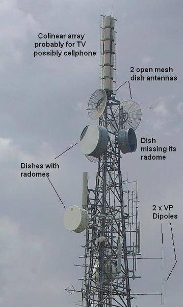

.... As you go higher in frequency above 1000MHz there becomes a trade off between size and gain and it becomes more practical to use a dish type antenna
in this next pic there are several dish antennas....
a radome is simply an E-M transparent shield/cover over the front of a dish to protect it from animals and the weather.
basic dish .....
Using ray paths as you would with an optical mirror you can see the incoming ( received signal) or the outgoing, transmitted signal, being reflected off the parabolic surface of the dish coming to or from the antenna feedpoint. Dish antennas produce very hi gain as they focus the radio signal into a narrow beam

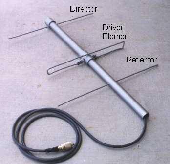

A basic Yagi antenna....
OK the pic above shows a simple 3 element Yagi ... the director element is at the front of the Yagi, then the driven element in the middle it is the active element and has the coax cable connected to it. Then at the back is the reflector element.
1 -- The director(s) element(s) are shorter than the driven element, ~ 5 - 10%.
2 -- The driven element is called a dipole and its length is a half-wavelength at the frequency its being used at, ( it is actually an electrical half wave-length, but we wont complicate the issue at the moment)
3 -- The reflector element is longer than the driven element, again ~ 5 - 10%
A dipole antenna on its own radiates reasonably evenly 360 degrees and is great if you want a wide coverage. But if you want to get a signal into a specific area then you use a Yagi with a reflector and one or more directors. This has the effect of confining the radio wave to a narrower beam so the signal can be aimed into a specific region.
OK lets see how you go digesting that and what questions it generates :)
I wanted to say, "I wish I owned the tower". Well maybe a lot off topic, but there's money to be made if you own one. The Department of Transportation here in Kansas has a information page as an example.
