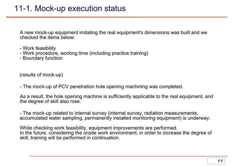

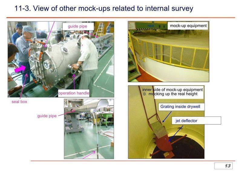

Quote by tsutsuji View Post
24 September 2012 government-Tokyo Electric mid and long term response committee, steering committee (10th meeting)
3-1 Cooling by closed loop water injection
http://www.meti.go.jp/earthquake/nuc...120924_01j.pdf Survey inside unit 1's PCV
1) Previous related topics:
http://www.physicsforums.com/showthr...54#post3934954 6th meeting (25 May 2012) Execution of internal survey into unit 1 primary containment vessel (PCV)
http://www.physicsforums.com/showthr...62#post4058562 9th meeting (27 August 2012) Execution of internal survey into unit 1 primary containment vessel (PCV)
http://www.tepco.co.jp/en/nu/fukushi...20927_02-e.pdf (27 September 2012) Punching an Access Hole at the Penetration (X100BPenetration) of Unit 1 PCV at Fukushima Daiichi Nuclear Power Station
2) Translation:
As most pages happen to be copies of August's presentation, I translate only the new materials found on pages 12-15 :
12/20
13/20

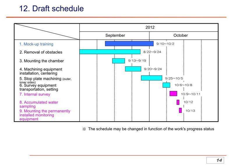

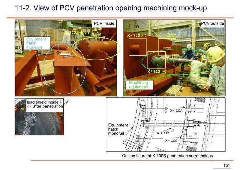

2) Translation:
14/20
15/20

I remain somewhat frustrated by the lack of articles about the initial footage inside reactor 1 containment.
I think the most detail I've seen anywhere is in this article, which suggests that the lead plates that were supposed to be on the end of the penetration they used were missing, presumed melted.

Thanks. I was not aware of that.
Here is the transcript of the 27 September press conference:
http://genpatsu-watch.blogspot.com/2...9271730-1.html [Tepco spokesman, Mr Ono comments the video ( http://photo.tepco.co.jp/en/date/201...20927-01e.html )] : Yesterday the penetration hole opening work was completed without problem. A video is available. I would like to show it to you. This picture is the result of inserting a camera to see how the hole was opened and for checking the situation after the hole was opened in the penetration with a cutter. [...] [he explains as the camera passes the ball valve, then the hole in the penetration stop plate, etc...] We have come to the inner side of the PCV. [...] Here it was originally the flange's outer side where a lead plate is mounted for shielding, but it was understood that it fell down and it is removed. That's what it is, and there is no need to open another hole in the lead plate, and it was confirmed that the entry inside [PCV] is possible. [then he comments as the camera progresses further inside the PCV][...]
NHK's Yokogawa: [...] As there was no lead plate, is the schedule going to be advanced ?
Ono : As a whole, the work must progress carefully, so I think it will be carried out almost as expected in the schedule.
[That's all they say about the lead plate]

May be lead plates are deformed by heat and one of them fall off when they worked on drilling through the wall to enter PCV with the endoscope ?

I dont know if the plate(s) fell down or melted completely, its certainly assumed that it got hot enough in containment for that sort of thing to happen I guess.
I will say that if we look at the photo taken in the reactor building which shows where the penetration is, there appear to be stains around the top of the equipment hatch plug which seem to support the idea of heat, smoke etc. Im talking about the photo that can be seen on the page labelled 3 of the translation tsutsuji did a while ago: http://www.physicsforums.com/showthr...62#post4058562
