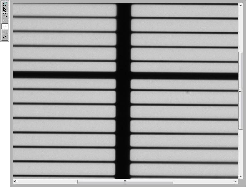

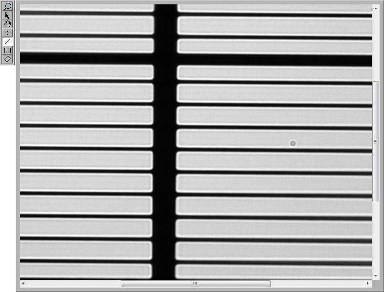

I saw these posts while searching answers and solutions for my custom-built miscroscope. The microscope I built is 20X, and I am using it to inspect some micro-structure samples. I tried two different illumination system. The first illumination system focuses a single wavelength LED to the sample (a micrometer) to illuminate it, the image quality seems great, see attached "LED Illumination.jpg". The second system focuses the single wavelength beam coupled into the system with a fiber to illuminate the micrometer, the image degraded. In the attached "Fiber Optic Illumination.jpg", you can see the bright borders around the black division marks. Here are my questions:
1. Is this degradation caused by defraction? I understand that the fiber increases the spatial coherence of the illumination beam. Could the NA of the focusing lens contribute to this? By the way, the division of the micrometer is 10um
2. Is there a solution to improve the image quality when a fiber optic cable is used to illuminate the sample?
Thanks!

I don't understand how you are illuminating the sample- in the first case, is the LED shining directly onto the sample, or is there a condenser lens? In the second, I have the same question and additionally, what kind of fiber is it- single-mode, multi-mode, fiber bundle, etc.. Lastly, some of the image features could be due to defocus/spherical aberration- how much control do you have over the focus movement (i.e. z-axis resolution), and how well can you locate the plane of best focus?
1. In the LED illumination, both collector and condenser lenses are used. These are moded glass asphric lenses with 25 focal length. The condenser is very close to the sample.
2. In the fiber illumination, a multi-mode fiber is used. A single precision-polished asphric lens is used to focus the beam on the sample. The distance between the focusing lens and the sample is much larger than the first case.
3. A micro-stage is uded to focus the objective lens to the sample. The focusing lens position is adjusted by hand and thus has less control, but from my experience working on these two different illumination system, it is unlikely the cause.
