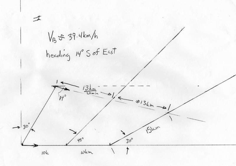

I think there might be two solutions but if we assume 30 degrees from north means towards east I think your numbers are off. Using ruler and compass I solved the problem graphically. I was careful and think my number are off less then 10%. See below,

Let's approach this geometrically. Let A, B be the initial positions, A', B' the positions after 20 minutes, and A", B" after 40. Spinnor's diagram is useful.
What angle are we told is 45 degrees?
What lines border that angle?
What vectors (treating A as the origin) correspond to the orientations of those lines?
Your equation (1) appears to be using OA', OB' as those vectors.
