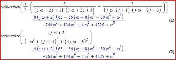

If any of you (possibly clever engineers) could, I have an algebraic nightmare (a few of them) in this thread: http://www.physicsforums.com/showthr...=1#post4165324
I'd REALLY appreciate some help!
As for the thread in the math section, I did, but I from what I've seen the people here stand a better chance of allowing me to figure it out.
You really need to get a computer program that can do equations like that. Otherwise you can spend hours and hours spinning your wheels and probably making lots of mistakes. I think there are some trial programs and freebies on the web from outfits like Wolfram, but I am not sure. Anyway, the first thing to do is rationalize both sides of the equation and see if they match. Rationalize means no complex terms in the denominator. That is a lot of work, but if they do match, then you proved they are equal and are finished. You rationalize the left side by first calculating a common denominator, and then multiply the numerator and denominator by the conjugate of each complex term in the denominator. Collect similar terms whenever you can. That is a lot of scut work, but it shows if the equations match. As you can see from the attachment, the right side should be twice what the rationalization shows to equal what the left side is, so the problem equation is wrong. You might be tempted to look for shortcuts by finding equal terms in the numerator and denominator, but for an equation that complex, you will probably just get tangled up trying to take advantage that situation. Best, I think, to just do it systematically. (Ugh)

Quote Quote by Ratch View Post
TB1,
You really need to get a computer program that can do equations like that. Otherwise you can spend hours and hours spinning your wheels and probably making lots of mistakes. I think there are some trial programs and freebies on the web from outfits like Wolfram, but I am not sure. Anyway, the first thing to do is rationalize both sides of the equation and see if they match. That is a lot of work, but if they do match, then you proved they are equal and are finished. You rationalize the left side by first calculating a common denominator, and then multiply the numerator and denominator by the conjugate of each complex term in the denominator. Collect similar terms whenever you can. That is a lot of scut work, but it shows if the equations match. As you can see from the attachment, the right side should be twice what the rationalization shows to equal what the left side is, so the problem equation is wrong. You might be tempted to look for shortcuts by finding equal terms in the numerator and denominator, but for an equation that complex, you will probably just get tangled up trying to take advantage that situation. Best, I think, to just do it systematically. (Ugh)
Ratch
Thanks, well I had no reason to think they wouldn't be the same, but you're saying they're not equal? That shouldn't be, are you sure?
For argument's sake if I just had the LHS and wanted to reduce it to the form of the RHS would I still have to do the conjugate times numerator and denominator? (surely not)
I was just looking for the simplest way to solve the LHS without expanding into 25 term polynomials and having to factorise cubics.
I've used wolfram on the net and I have matlab and I think maple (which I've never used) but I don't know what I'd use to show me how to solve anything like that.
Ratch

TB1,
Yes, I am. I used Maple, and it has never given me a wrong answer. I rationalized both the RHS and the LHS, and they don't come out equal. You can spend a lot of time trying to wrestle one expression into another, especially if they are not equal. There are a zillion alternative ways to represent an expression, but if you know the end result, it is best just to determine if they are equal and walk away.
To do it the hard way, first rationalize it. Then multiply the numerator by a hairy factor to get what you want in the numerator. Multiply the denominator by the same factor to keep everything equal. Simplify the denominator. Then use the terms in the denominator, and factor if necessary to create your own expression. You have to use all the denominator terms, and cannot use extra terms. Of course, you can use the computer to subtract the terms you use, and factor if necessary. The choices are many.
You are not solving an equation. You are proving an equality.
Sounds like you are well stocked with software.
Ratch

TB1,
Thanks for pointing out that they're not equal, I could have wasted even more time.
I'll have to give maple a go when I get a chance. To varify.
To clarify, these two steps were in someone's working out, and I didn't know how they got from LHS to RHS, it wasn't a question of proove they're equal or not (if there's been a misunderstanding). I still dont see how I'd factorise the denominator to get it like ()^2 + ()^2 from the denominator of your (1). To do this it doesn't matter if there are j's in the denominator.
You can see from the attachment that I used the rationalize function of Maple. I would have thought that Matlab and the Wolf could do what Maple did. Maple can factor expressions, but that is not necessary to rationalize an expression, even if you do it manually. You need to multiply by conjugates to get rid of complex terms in the denominator. Then use the procedure I outlined previously to make any expression that is possible from the terms in the denominator.
Ratch

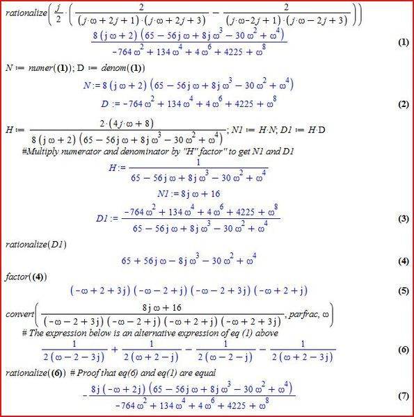

TB1,
Just to follow up on your previous question about that math expression. If you look at equation (6) of the attachment, you can find an alternative form of that expression. If fact, there are many different forms. Once you have the denominator rationalized, you can use partial fraction expansions. Then the number of different expressions is only limited by your imagination.
Ratch
