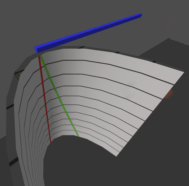

Some space-time diagrams to help visualzie what's going on since the math is so messy. The first is a standard 2d rindler diagram, with time (going up the page) and the z axis shown, which represents a single accelerating observer.
But we need t,z, and also x for the issue under discussion, so we need a 3-d diagram. We need to stack a bunch of these diagrams on top of each other. Hence, the next diagram, the 3d one.
The blue line is time. The black lines are plots of z vs time for an ensemble of rockets. The red line shows the "x" axis, a line of simultaneity for someone with dx/dt = 0. The lines all have the same z coordinate, the rocket floor is level for someone with no x motion.
[img] http://www.physicsforums.com/attachm...4&d=1351336667 [/img]
The green line shows the line of simultaneity along the x axis for someone who is not stationary. You can see from the diagram, hopefully, why the rocket floor isn't level anymore when we start to move across it.
Very interesting but hard to visualize.
Let me see if I am getting it at all.
If there is a vertical line for the x axis with a horizontal line crossing it being the z axis and the floor. With the y axis projecting from the intersection towards us.
no explicit time axis. Time being the floor moving up the page.
Then a particle moving horizontally from some z point across the floor with constant motion must describe a non-linear curve over any time interval due to acceleration. SO in this sense the floor is curved as described by this motion. Is this at all what you are talking about???

This 2d diagram has an explicit time axis (time for an observer at rest) going up the page, and an explicit z axis, going to the right.
Hmmm - I snarfed it from somewhere, it's labelled as the x axis. Oh well. That's a standard plot for accelerated motion.
The 3-d diagram adds an x axis, which you can't see in the 2 d diagram. The x axis for an observer at rest is the red line. The x-axis for a moving observer is the green line
The time axis on the 3-d diagram is the blue line - it's the time axis for an observer "at rest".
There isn't any explicit line for the z axis on the 3-d diagram, but it's orthogonal to t and x.

Sorry if I was unclear. I was not describing your diagram. I was describing a simpler orthographic view from an inertial frame where the idea was a series of superposed time snapshots of the floor moving up the page with the object moving across the floor.
In the accelerating system an inertial particle moving along the z axis at some initial positive x would be charted as a curve with motion also in the -x direction.
So from an inertial frame the accelerating car (?) across the floor would be charted as a curve with a component of motion in the +x direction.
I was wondering if this was what you were referring to as curvature of the floor.
Within a Rindler system the metric is static and such motion would be equivalent to driving a car with constant velocity some distance on a flat road on earth. Effectively inertial, disregarding the constant g . In that context would you say the road was curved?
Since a line of simultaneity is limited to an instant of equal proper time by definition I am not sure how to interpret the green line that extends through a range of coordinate time per your blue line???
