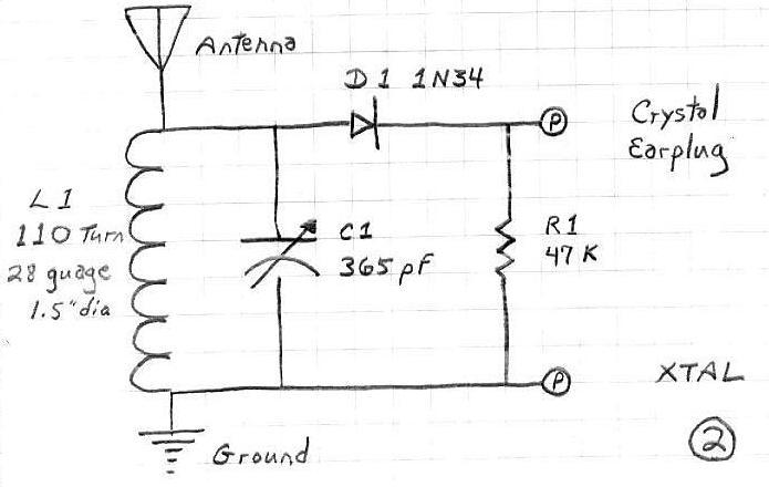

OK some circuit examples ....
a basic tuned circuit ... an inductor in parallel with a capacitor along with a detector diode and you have a radio receiver...
