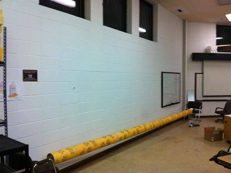

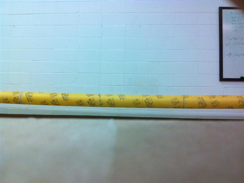

This is a real world project. I'm building a giant roll-up window shade to be used for a special effects green screen.
The first real model attempt (without math) failed. See the two pictures of the tube structure being held up by chairs. The only axle was about 3ft of 1.5" pipe at each end. The rest is 8" diameter concrete tubes. We double walled the tubes by slicing the length of one and using it as a coupler inside to hold two tubes end to end. We made about twelve 3/4" wooden disks to help support the structure and secure to the axle. Deflection in the middle was too great.
Second attempt in next post.

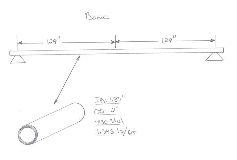

Here are my drawings of the stages to completed.
Basic drawing:
This might be the easiest place to start. The screen only weights 23lb total and will be even across the entire beam.

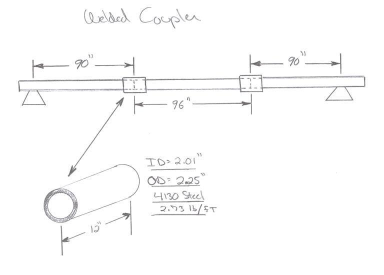

Coupler drawing:
Because I can't order large lengths of pipe, sections will need to be welded. This adds weight and weak points. I have some samples of pipe here. Two ends can be welded, then a coupler pipe slid over and welded also.

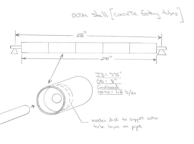

Outer shell drawing:
Because the screen needs to be rolled up and down, we need an 8" diameter concrete tube which will take 9-10 revolutions to wrap it up. An option here would be to use even larger diameter tubes (note: wall thickness is the same for all diameter tubes).

Moment is force times distance.
My thinking is because it's supported at both ends, I can run math for half of the beam.
But what is my force?
Weight:
Support to middle of center pipe: 10.75' x 1.343lb = 13.43lb
One coupler: 1' x 2.73lb = 2.73lb
Outer shell: 10' x 1.2lb = 12.0lb
1/2 of green screen weight: 11.5lb
total half weight of beam: 39.66lb
Moment (M) = Force x Distance
M = 39.66lb x 129in, == 5116.14in-lb
Let me consider the stress of the basic single pipe/beam model:
Stress (S) = M x C/I
C = outside radius of pipe (1")
I = moment of Inertia of pipe
I = pi x OD^4/64
= 3.14159 x 2^4/64 == 0.7854 in^4
and S = 6514.06psi
What will be the deflection?
D = (F x L^3) / (3 x E x I)
Where:
D = Deflection at the center of beam
F = Force at center of beam (39.66lb)
L = Length to center (129in)
E = Young's modulus for steel material (30,000,000 psi)
I = moment of Inertia (0.7854 in^4)
D = (39.66 x 129^3) / (3 x 30,000,000 x 0.7854)
== 1.205 inches
This basic model, if I'm correct, is bending quite a bit.
There is probably some other weight I didn't factor in so this will be a minimum deflection.

Strength of welded coupler. Could this increase deflection or decrease it?
Strength of the concrete tubes (with wooden disks, note: there will be concrete tube couplers here as well, just not the entire length like in the first attempt).
My thinking is the concrete tubes will add to the deflection making this attempt a failure on paper.

Shouldn't you be using this equation, but with full beam weight?
That'd give you a computed deflection less than 0.5 inches. What's your design limit?
massta said:
I = pi x OD^4/64
Isn't that MI for a solid pipe? Your pipe is hollow.MI will be a lot less then (for same OD!).
Besides that's the worst case scenario: A concentrated center load. A uniformly loaded beam will deflect a lot less I think. Probably ~60% of the concentrated center load case?
Also, wouldn't supporting it on chairs exaggarate the deflection than a real mount? How are you going to mount the ends? A fixed support end condition should give perhaps ~30% of the beam center deflection as a simply supported end point. I'm not sure which one is a realistic assumption for your mounts but I suspect the chair-mount misleads you.
PS. Apologies if any of this is wrong; I'm no structural expert. I'm glad to be corrected.

@rollingstein, you are correct. I made the mistake of using a solid beam.
For hollow tube:
I = pi * (OD4 - ID4) / 64
Where:
pi = 3.14159
OD = the outside diameter (2 in)
ID = the inside diameter (1.87 in)
so I = 0.185142 in^4
plug in new I for Deflection:
D = (F * L^3) / (3 * E * I)
D = 5.11 in !
answer: steel is too flexible

Isn't this still the wrong formula for D? You seem to be using a cantiliver eq. The beam eq. gives you a lesser deflection. Especially adding in uniform loading and restrained supports I doubt you'd see more than 0.5 inches.
5 inches sounds like a lot.
Did some number crunching:
Uniform Load of 0.3 lb/in and fixed supports gives max deflection 0.6 inch
Even if you consider all weight (80 lb) concentrated at beam centre I get a deflection of 1.2 inches with fixed supports.
Main problem is roller supports; then deflections jump to the 3-5 inch range.
I'd like to see your formula.
The only support is at then end, I understand the force is even throughout the beam but it only has one support so the entire force (or 1/2 because there are two supports) are enacted here. That said, all of the weight isn't at the middle, it's spread out. So this is where I could use some help.
~Shawn

Going through the numbers again for a simple supported beam:
Pipe/beam:
OD: 2in
Length between simple supports: 258in
Total weight/load: approx 80lbs (includes all materials) or 0.2899lb/in
L = Length (258in between supports)
I = pi/64 * (OD^4 - ID^4); I = 0.18514in^4
Deflection: d = w * OD^4 / (384 * E * I)
d = 0.2899lb/in * (2^4) / (384 * 30,000,000 * 0.18514in^4)
d = an incredibly small number!
making a mistake somewhere...ugh
so deflection has nothing to do with Stress or Moment?
massta said:
This idea is great. By deflecting the ends with a special bracket, it will put an opposite deflection in the beam. When the beam has a load it will straighten out. Only problem is the beam will bow when the screen is unrolled, so better to make it as stiff as possible.
Pipe/beam:
OD: 2in
Sorry, my bad. I had Do instead of L in the deflection equation. I've edited the post. You should get a deflection of 0.8967"
Pipe/beam:
OD: 2in
Deflection: d = w * L^4 / (384 * E * I)
d = 0.2899lb/in * (258in^4) / (384 * 30,000,000psi * 0.18514in^4)
d = 94.9 in
How did you get 0.8967?
hmmm...
I was using this eq. in my original math:
Check again. You should get 0.6022. I accidentally input 285" in length and got .8967".
The Superbowl is being distracting! lol
Oh... and when deflecting the ends of the beam you would maintain a moment on the ends of the beam so that as it rotates it remains relatively straight. You might imagine a couple of rolling element bearings on the end of the beam so that they tend to point the beam upwards toward the center. Those bearings would simply maintain a moment on the end of the beam tending to flatten the curvature. The beam wouldn't change shape as it rotates so the sag in the beam wouldn't change as it turns. Think about it...
d = 94.9 in
hmmm...
I see what you did. You raised the moment of inertia (0.1851 in4) to the 4'th power. Those are just units. Understand?
massta: You would want to keep the design as simple as possible. Therefore, you would want to use just a simply-supported beam, which is just your steel pipe. Roll your screen directly onto your steel pipe. Rotate the pipe faster, to obtain the same effect.
Therefore, for your current given data, the simply-supported beam midspan deflection would be, y = 76.49 mm, which is fine. This is not a huge deflection, and is OK. If you want the deflection to be less, then simply use a larger-diameter SAE 4130 steel pipe. If you choose a larger-diameter steel pipe, then give us the pipe OD and ID, and we can check your simply-supported deflection calculation.
