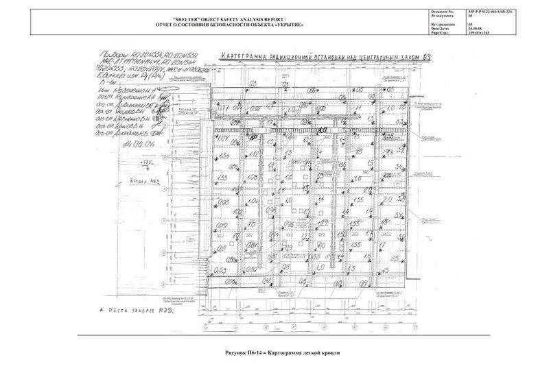

Notice about abnormal situation
12.02.13. Partial failure of the wall slabs and light roof of the Unit 4 Turbine Hall occurred at 14.03 above non-maintained premises on the level 28.00 meters in the axes 50-52 from range A to rage B. The area of damage is about 600m2. This construction is not critical structure of the "Shelter" object.
There is no violation of limits and conditions of "Shelter" object safe operation in accordance with the technological regulations. There are no changes in radiation situation at ChNPP industrial site and in Exclusion zone. There were no.
