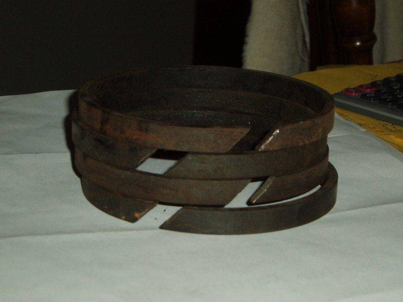

Thanks Q, let's see now..if I remember correctly Mr. Otto and I used technology that was currently available ...we borrows the piston ring technology used on steam engines. The pressure of an internal combustion engine is significantly greater and we had to modify the rings to use the combustion pressure to properly seal the combination.. see Stanley steamer 735 engine piston rings attached..( hey..I'm old but not that old..people!)one more point.. Sprint cars must be push started as the builders eliminate the starter and clutch assembly to get the lightest combination. Consequently the engine spews fuel and oil for the first couple of laps until the engine heats to operating temperature..every race night these cars are out on the track means a super slick asphalt track..I hate it..can you imagine what would happen if we made a piston with no rings and relied on the heat to expand the piston to close the clearances..What a mess..EPA sure would be all over us like Ugly on an Ape!
