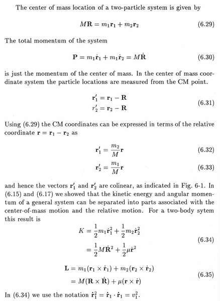

I've just looked at the Wikipedia page, and I understand completely why you are confused. Maybe this derivation, taken from V. D. Barger and M. G. Olsson, Classical Mechanics: A Modern Perspective, 2nd ed., McGraw-Hill (New York), 1995, will be more helpful.

DrClaude said:
The key word in that quote is "pretend." This is not rigourous. But indeed, if one of the objects is much more massive than the other, then the center of mass of the system will be located close to the middle of the massive object, and therefore you can imagine that it is as if you had an object of mass [itex]m_\mathrm{red}[/itex] orbiting in a closer orbit around the massive object.
Thank you for that derivation, DrClaude
DiracPool said:
why does a-rel = a1-a2 instead of say, a2-a1?
I expect that it doesn't make any difference in the end. That is, you could just as well start with arel = a2 - a1, and along the way you might have 1 and 2 switched around in some places, or maybe some + and - signs switched, but the differences will cancel out eventually. Try it and see what happens!
That just corresponds to a 180º rotation. So if in the inertial frame one object is at (-1,0,0) and the other object is at (3,0,0) then you can either adopt the convention that their relative position is (4,0,0) or (-4,0,0). Either way works fine, but your accelerations will all be 180º "out of phase".
