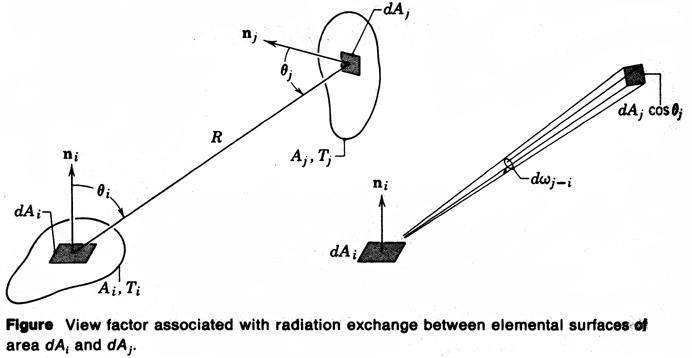

Does anybody out there know how to find the view factor of a tillted cylinder-shaped poolfire?

the shape of the absorbing area is a very small rectangle. the emmiting area is a sheared tilted cylinder.but it retains its circular shape.say the absorbing area is a person, the view factor needed does not include the top and bottom part of the cylinder.only part of the side of the cylinder that can be viewed by the person is taken into account

The view (or configuration) factor F[usb]ij[/sub] is defined as the fraction of radiation leaving surface i, which is then intercepted by surface j. Consider two arbirarily oriented surfaces Ai and Aj. Then consider the elemental areas designated as dAi and dAj, which are connected by a line of length R, which forms polar angles [itex]\theta_i[/itex] and [itex]\theta_j[/tex] with respect to the surface normals <b>n</b><sub>i</sub> and <b>n</b><sub>i</sub>, respectively. Note the values of R, [itex]\theta_i[/itex] and [itex]\theta_j[/tex] vary with position and orientation (relative to both areas) of the two areas.<br /> <br /> Let [itex]\large dq_{i\rightarrow j}[/itex] be the rate at which radiation leaves dA<sub>i</sub> and is intercepted by dA<sub>j</sub>, then<br /> <br /> [itex]\large dq_{i\rightarrow j} = I_i cos \theta_i dA_i d\omega_{j-i}[/itex]<br /> <br /> where [itex]I_i[/itex] is the radiation intensity leaving surface i and [itex]d\omega_{j-i}[/itex] is the solid angle subtended by dA<sub>j</sub> when viewed from dA<sub>i</sub>.<br /> <br /> By definition of the solid angle,<br /> <br /> [itex]\large d\omega_{j-i}[/itex] = [itex]( cos \theta_j dA_j) / R^2[/itex], then it follows that<br /> <br /> [itex]\large dq_{i\rightarrow j} = I_i cos \frac{\theta_i \theta_j}{R^2} dA_i dA_j[/itex] and letting [itex]J_i = \pi I_i[/tex], this becomes<br /> <br /> [itex]\large dq_{i\rightarrow j} = I_i cos \frac{\theta_i \theta_j}{\pi R^2} dA_i dA_j[/itex].<br /> <br /> Then integrating over surfaces A<sub>i</sub> and A<sub>j</sub>, the total rate at which radiation leaves surface i and is intercepted by j is given by,<br /> <br /> [itex]\large q_{i\rightarrow j}\,=\,J_i \int_{A_i}\int_{A_j} \frac{\theta_i \theta_j}{R^2} dA_i dA_j[/itex]<br /> <br /> and from the definition of the view factor,<br /> <br /> F<sub>ij</sub> = [itex]\large \frac{q_{i\rightarrow j}}{A_i\,J_i}[/itex]<br /> <br /> or<br /> <br /> F<sub>ij</sub> = [itex]\large \frac{1}{A_i} \int_{A_i}\int_{A_j} \frac{\theta_i \theta_j}{R^2} dA_i dA_j[/itex][/itex][/itex][/itex]

This figure should go with the tex equations above.
