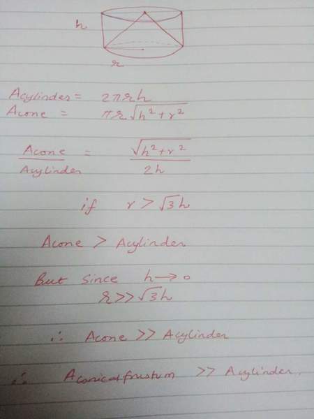

Thankyou for all the replies. :)
I would just like you to look at the attatchment, where ive tried to convince myself.
If we compute the surface area by using CYLINDERS we end up getting a LESSER area than 4∏R^2 .The reason why cylinders do not work, is because "for an infinitesimally small height dh" the area of the ACTUAL surface of the sphere (which represents a conical frustum, i have taken CONE in this case) will always be greater than the surface area of the CYLINDER enclosing it.

yes, that's correct, the frustrum area will always be more by a factor secθ, where θ is the half-angle of the cone …
(but your diagram doesn't really work, it needs to show a proper frustrum, rather than one that goes up to the apex of the cone )

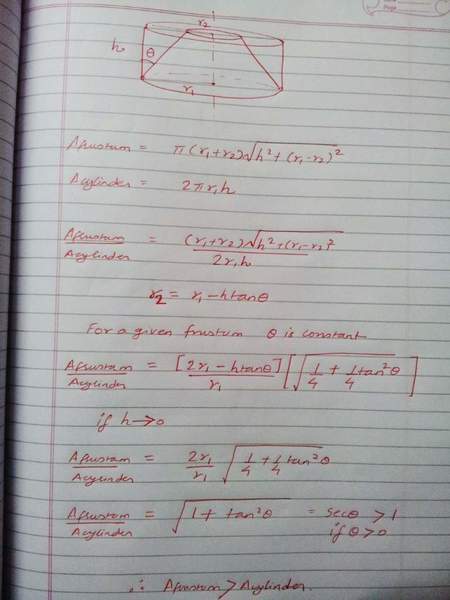

Thanx again :)

yes, that's fine!
but you could shorten it by using θ from the start …
your first line could be Afrustrum = π(r1 + r2)secθ
and then show that the bracket = 2r1 as r1 - r2 -> 0
(btw, archimdedes managed to prove this without modern maths …
you may be interested to read this: http://arcsecond.wordpress.com/tag/archimedes/)
