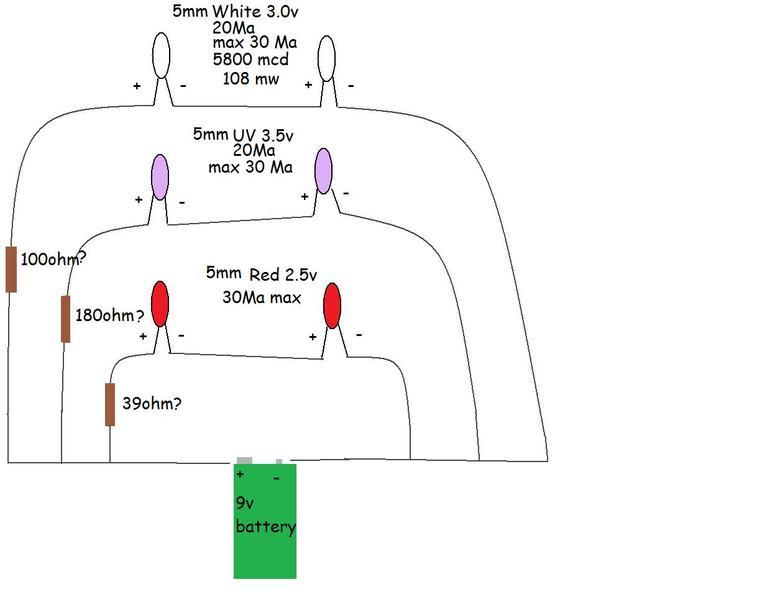

Hi all, I am a new guy to the forum, glad to meet you all. iv been doing a little rc project and now need to wire up some lights. iv never done circuit work before but I am willing to gain knowledge on how to.
the main problem is that no matter how much i read or calculate, i cannot work out what resistors i will need or if my circuit is even possible.
i want to run 3x 2 led circuits off one 9v power supply. is this possible?
here is a quick sketch of what i was thinkin..any info is much appreciated. thanks

Also, would i be better off using 2 circuits of 3 leds? i would need a red, white and UV on one circuit which would add up to 9v exactly, would i need to run a resistor or not, would it even work? iv drawn that many diagrams I am starting to confuse myself so sorry for the 'novice' questions

the way you've drawn them, in parallel, you'll be putting 9v through each pair (4.5v through each individual one), and they're only rated 2.5v to 3.5v (is that each, or per pair?) …
will that damage them? :confused:
if you're trying to keep the voltage drop across each the same as the rated voltage, you need to put each one in series with a resistor, or to put them all in series with each other and a resistor
(I = 9/∑R, V1 = IR1 etc)
Thanks Tim, that's was something i wasnt sure of, thought it was best to check with you guys first. is there any chance u could draw me up a little diagram and list of components please, i just don't get which way to go about it.
should i run a resistor to each LED?

Also, your original circuit can work, you just have the wrong resistor values. For example, you're putting about 100mA through your red LEDs, and that will destroy them and possibly burn up the resistors if they're not rated for enough power dissipation.
Using what I told you in my first post, I'll do the calculation for your red LEDs, and then you can use this example to calculate the resistor values for the other 2 pairs.
Voltage Supply = 9V
approximate LED drop = 2.5V x 2 = 5V
Resistor Voltage = 9V - 5V = 4V
Let's say we want 10mA in the LEDs, then we can calculate the resistor value:
R = 4V/10mA = 400 ohms
Now, the last thing to check is if we can find a resistor capable of dissipating the power it drops:
P = I^2*R = 0.01 * 0.01 * 400 = 0.04 = 40mW. You can buy resistors rated for this much power, so your circuit can work at 10mA.
