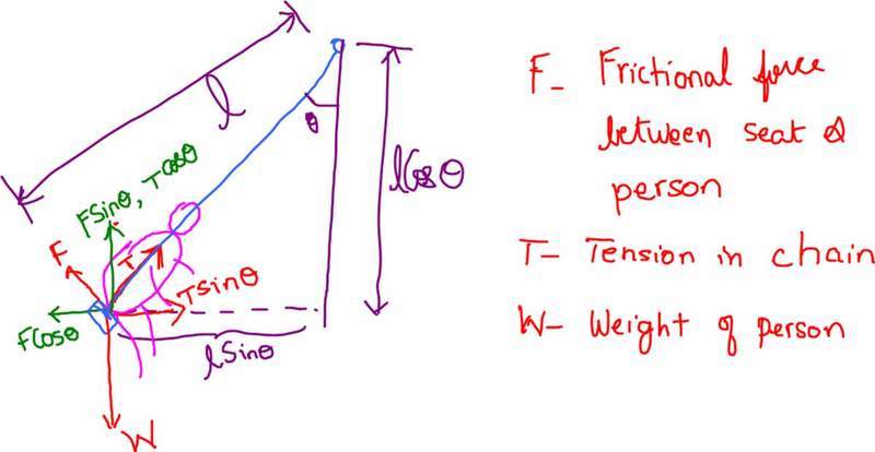

This is a very basic question,I also attempt to learn more from it.Some additional info would also be of great help.
A girl whose mass is 40kg is using a swing set.The diameter of the wire used for constructing the links of the chain is 5mm.Determine the average normal stress in the links at the bottom of the swing,assuming that the INERTIAL FORCES CAN BE NEGLECTED.
Q.The question is regarding the INERTIAL FORCES.I have drawn the resolution of forces diagram(attached and I am not sure it's correct).Here,where does one include the inertial/pseudo forces in this accelerating frame of reference?
Q.Is this inertial force- 'pseudo' in the sense that the sagging of the swing appears from a imaginative force taking the swing as the reference frame?
Hope the questions are clear.Please view the attachment diagram.

Ignoring inertial forces in this problem means that tension is due to supported weight only. You basically solve this problem for swing at lowest point and v=0.

Ignoring the mass of the chain and the swing, the only inertial force would be equal to the reaction force of the girl's 40kg body to centripetal acceleration, which is exerted onto the swing. From the swings rotating frame of reference the inertial force is the apparent centrifugal force exerted on the girls body. The swing exerts a real and non-inertial force onto the girl to oppose both the inertial force (swing frame of reference, or reaction force if using an inertial frame of reference) and weight.
As K^2 mentioned, it appears that you're supposed to assume that the girl and the swing are at rest, and not moving, but that isn't a very interesting problem, since the only force opposed by the chain is due to the girl's weight.

I find it very misleading to talk about inertial forces as reaction forces. Inertial forces are never part of a Newtons 3rd action-reaction pair.
Quote by rcgldr View Post
There is no centripetal acceleration in the rest frame of the swing, where inertial forces appear. The swing and body are static here.
The swing exerts a real and non-inertial force onto the girl to oppose both the inertial force and weight.
This is correct. The real centripetal froce on the body by the swing is opposing the inertial centrifugal force on the body. But they are not an action-reaction pair. They both act on the same object (the body), unlike action-reaction force pairs which act on a different object each. The reaction force to the real centripetal force on the body by the swing is the real reactive centrifugal force on the swing by the body.
