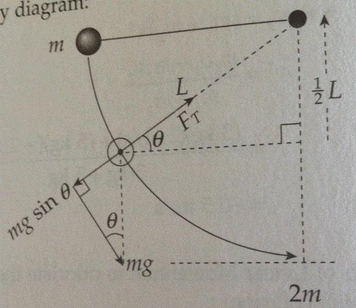

Also, in the diagram, it says m becomes 2m...?

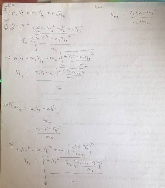

This is possibly one of the ugliest equations I've seen.
I can't set the two Vf1 equal to each other, that would lead to 0. But I also can't figure out where to go from there.

You have the two equations:
##m_1(v_{i_x})_1 = m_1(v_{f_x})_1 + m_2(v_{f_x})_2## (1)
and
##\frac{1}{2} m_1(v_{i_x})_1^2 = \frac{1}{2} m_1(v_{f_x})_1^2 + \frac{1}{2} m_2(v_{f_x})_2^2 ## (2)
In equation (1), start by isolating ##(v_{f_x})_1##; call this equation (3). Then substitute the result into equation (2).
After some pain, you wind up with:
##(v_{f_x})_2 [(1 + \frac{m_2}{m_1})(v_{f_x})_2 - 2(v_{i_x})_1 ] = 0##
So either ##(v_{f_x})_2 = 0## or ##[(1 + \frac{m_2}{m_1})(v_{f_x})_2 - 2(v_{i_x})_1 ] = 0##.
If ##(v_{f_x})_2 = 0##, then ball 1 completely missed the other ball. So you want the other solution, which will give you a solution for ##(v_{f_x})_2##. This solution happens to be one of your two equations.
To get the other equation, sub back ##(v_{f_x})_2## into equation (3), which will yield the other equation.
Thanks, you're awesome! The algebra was a total pain.
