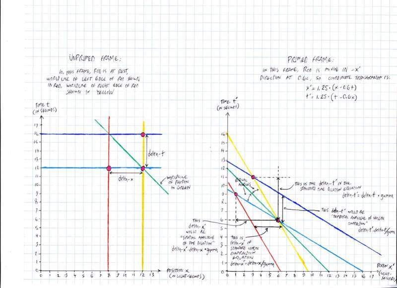

  • #80
JesseM said:
it's also possible to come up with a "temporal analogue for the length contraction equation" which looks like the length contraction equation but with [tex]\Delta t[/tex] substituted for L (this is more difficult to state in words, but it's basically the time-interval in the primed frame between two surfaces of constant t in the unprimed frame which have a temporal distance of [tex]\Delta t[/tex] in the unprimed frame, which is analogous to how length contraction tells you the spatial distance in the primed frame between two worldlines of constant position in the unprimed frame which have a spatial separation of L in the unprimed frame).
Suppose Alice and Bob are each wearing a watch. Bob, moving in the positive x direction in Alice's rest frame, at 0.6c, passes Alice and they synchronise watches. Some time later, Alice looks at her watch and wonders, "What time does Bob's watch say at the moment which in Bob's rest frame is simultaneous with me asking this question?" The answer is given by [tex]t_{B} = \gamma t_{A}[/tex], the standard time dilation formula. If Alice's watch says 4, Bob's will say 5. "How about that," thinks Alice. "To Bob, for whom my watch is moving, it's running slow."
Now suppose that Alice wonders, "What time does Bob's watch say at the moment which in my rest frame is simultaneous with me asking this question?" The answer to this is given by [tex]t_{B} = \frac{t_{A}}{\gamma}[/tex]. If Alice's watch says 5, Bob's will say 4. "Fancy," thinks Alice. "From my perspective, Bob's watch, which is moving relative to me, is running slow."
And, of course, Bob can ask the equivalent questions about the time on Alice's watch with identical results by virtue of the fact that the two frames don't agree on which events are simultaneous (except for those that happen in the same place, such as their synchronisation).
But isn't Alice's second question none other than this exotic "temporal analogue for the length contraction equation"? She wants to know "the time-interval in the primed frame" (the time shown by Bob's watch, indicating a time interval along Bob's worldline) "between two surfaces of constant t in the unprimed frame" (one being the one which Alice and Bob's worldlines intersected when they synchronised watches, the other being Alice's present when she looks at her watch) "which have a temporal distance of [tex]\Delta t[/tex] in the unprimed frame" (the time shown by Alice's watch when she looks at it and makes her query).
Is Alice's second question in any way less natural than the first, or a less useful thing to ask of time than of space? I'm puzzled as to how it can be, if it is, as Jesse said, "just a trivial reshuffling of the usual time dilation equation"?
  • #81

  • #82
Here you can use the time dilation formula too. If the time dilation formula is written [tex]\Delta t' = \Delta t * \gamma[/tex], then that' formula is comparing the amount of time that's elapsed on a clock (whose rest frame is labeled the unprimed frame) with the amount of time that's elapsed in a frame where the clock is moving, with "time elapsed" in that frame being based on that frame's definition of simultaneity (and with this second frame being labeled primed). So in your second example, the clock is Bob's and the second frame whose definition of simultaneity you're using is Alice's, so you can just treat Bob's frame as the unprimed frame in the standard time dilation equation and Alice's question will be the same as asking for the time elapsed in the primed frame, meaning you're just substituting [tex]t_A[/tex] and [tex]t_B[/tex] into the time dilation equation giving [tex]t_A = t_B * \gamma[/tex]. Of course, if you wish to divide both sides by gamma, you can get back the formula [tex]t_{B} = \frac{t_{A}}{\gamma}[/tex] you wrote above, but this is just a reshuffling of the time dilation equation.
But you do raise a great point which I hadn't thought of before, which is that the "temporal analogue of the length contraction equation" can always be used to calculate things that you'd normally use the time dilation equation to calculate, provided you reverse the meaning of which frame is primed and which frame is unprimed. Let me give a numerical example similar to yours. Suppose Bob is moving away from Alice at 0.6c and that both their clocks read 0 when they crossed paths as you suggested. But instead of starting Bob's time interval when his clock reads 0 as in your example, suppose we were interested in the time interval on Bob's clock that started with the event of his clock reading [tex]t_{B1}[/tex] = 8 seconds, and ended with his clock reading [tex]t_{B2}[/tex] = 12 seconds, so the length of the interval in Bob's frame is [tex]\Delta t_B[/tex] = ([tex]t_{B2}[/tex] - [tex]t_{B1}[/tex]) = 4 seconds. If Alice wanted to know the time interval [tex]\Delta t_A[/tex] between these same two events in her frame, which is equivalent to wanting to know the time interval between the event [tex]t_{A1}[/tex] on her clock which is simultaneous in her frame with [tex]t_{B1}[/tex] (in this case [tex]t_{A1}[/tex] = 10 seconds) and the event [tex]t_{A2}[/tex] on her clock which is simultaneous in her frame with [tex]t_{B2}[/tex] (in this case [tex]t_{A2}[/tex] = 15 seconds), then she would plug these two different time intervals into the time dilation equation [tex]\Delta t' = \Delta t * \gamma[/tex], treating Bob's frame as unprimed and her frame as primed, which gives [tex]\Delta t_A = \Delta t_B * \gamma[/tex]. If she wanted to reverse this and figure out the time interval [tex]\Delta t_B[/tex] on Bob's clock between two events on [tex]t_{B1}[/tex] and [tex]t_{B2}[/tex] on his clock's worldline that are simultaneous in her frame with two events on her clock's worldline [tex]t_{A1}[/tex] and [tex]t_{A2}[/tex] that are the beginning and end of a time interval [tex]t_A[/tex] (in the example above she would start with times 10 seconds and 15 seconds on her clock and then try to figure out how much time had elapsed on Bob's clock between these moments in her frame), she'd just divide the time dilation equation by gamma so it gives [tex]\Delta t_B[/tex] as a function of [tex]\Delta t_A[/tex], i.e. [tex]\Delta t_B = \frac{\Delta t_A}{\gamma}[/tex].
On the other hand, the "temporal analogue of length contraction" [tex]\Delta t' = \Delta t / \gamma[/tex] would be telling her something conceptually different, assuming she continues to treat Bob's frame as unprimed and her frame as primed. Basically, it would be saying "if you use [tex]t_{A1}[/tex] to label the time on Alice's clock that's simultaneous in Bob's frame with Bob's clock reading [tex]t_{B1}[/tex], and you use [tex]t_{A2}[/tex] to label the time on Alice's clock that's simultaneous in Bob's frame with Bob's clock reading [tex]t_{B2}[/tex], then the time interval on Alice's clock ([tex]t_{A2} - t_{A1}[/tex]) is related to the time interval on Bob's clock ([tex]t_{B2} - t_{B1}[/tex]) by the formula [tex](t_{A2} - t_{A1}) = (t_{B2} - t_{B1}) / \gamma[/tex]. If we use the same numbers for [tex]t_{B1}[/tex] and [tex]t_{B2}[/tex] on Bob's clock as before, namely [tex]t_{B1}[/tex] = 8 seconds and [tex]t_{B2}[/tex] = 12 seconds, then in this case we'd have [tex]t_{A1}[/tex] = 8*0.8 = 6.4 seconds (I just multiplied 8 by 0.8 because I know both clocks read 0 when they were next to each other and Alice's clock is moving at 0.6c in Bob's frame, so the standard time dilation equation tells me her clock is slowed by a factor of 0.8 in his frame) and [tex]t_{A2}[/tex] = 12*0.8 = 9.6 seconds. So the equation [tex](t_{A2} - t_{A1}) = (t_{B2} - t_{B1}) / \gamma[/tex] does work here, since [tex](t_{A2} - t_{A1}[/tex] = 9.6 - 6.4 = 3.2, [tex]t_{B2} - t_{B1}[/tex] is still 4 seconds, and gamma is still 0.8. But you can see that the time interval in Alice's frame we're talking about now (3.2 seconds) is different than the time interval in Alice's frame we were talking about when we were using the usual time dilation equation (5 seconds). But, that's only because we were treating Alice's frame as the primed frame in both equations! If we reverse the labels and treat Bob's frame as primed and Alice's frame as unprimed, then the standard time dilation equation [tex]\Delta t' = \Delta t * \gamma[/tex] does tell you that when 3.2 seconds have elapsed on Alice's clock, 4 seconds of time have passed in Bob's frame (or equivalently, if you look at the readings on Bob's clock that are simultaneous in Bob's frame with the two readings on Alice's clock, the difference between these two readings on Bob's clock is 4 seconds).
So I guess if you take the time dilation equation and divide both sides by gamma to solve for the interval in the primed frame, this is really just equivalent to taking the "temporal equivalent of length contraction" equation and reversing which frame we call primed and which we call unprimed. To me there's still a little bit of a conceptual difference though, in the sense that normally I think of these equations as relating a clock time-interval to a coordinate time-interval, with unprimed normally being the clock time-interval. For instance, when I read the time dilation equation [tex]\Delta t' = \Delta t * \gamma[/tex], I find it most natural to think that [tex]\Delta t[/tex] represents the difference between two clock-readings on a clock at rest in the unprimed frame, and then [tex]\Delta t'[/tex] represents the difference between the coordinate times of these two readings in the primed frame. Of course, because a clock at rest in the primed frame will keep time with coordinate time in that frame, this is equivalent to imagining there's also a clock at rest in the primed frame, and saying [tex]\Delta t'[/tex] represents the difference between two readings on the primed clock that are simultaneous in the primed frame with the two readings on the unprimed clock that were mentioned earlier. The first way of stating it just makes the usefulness of the time dilation equation more intuitive to me; as I said before, physics is all about setting up a spacetime coordinate system and then using equations to figure out how the state of objects in space changes as the time-coordinate increases.
  • #83
JesseM responding to Rasalhague:
<snip>
Thanks, I think you've given an answer my original question. I think you have said this:
There is another way of approaching the relativistic effects other than time dilation-length contraction. That is to use "temporal analogue of the length contraction equation"-length contraction. However, using time dilation is more intuitive to you - and possibly also for the majority of people. That said, there is nothing inherently wrong with using a "temporal analogue of the length contraction equation" (although one must note that a different prime convention is required).​
Rasalhague has shown me that instead of:
What exactly is the greater utility of time dilation and length contraction equations which prevents the use of two contraction equations ...?
I should have asked:
What exactly is the greater utility of length contraction and time dilation equations which prevents the use of a length contraction equation and a temporal equivalent of the length contraction equation ...?
For that I thank you Rasalhague.

  • #84
Yes, although I hadn't actually realized that the "temporal equivalent of length contraction" equation could be used to answer exactly the same physical questions as the time dilation equation until Rasalhague asked that. And it was the specificity of the way he asked the question that made me realize this--he was asking about particular events on the worldlines of two physical clocks and stating in which frame an event on one clock's worldline was supposed to be simultaneous with a corresponding event on the other clock's worldline. You say that you "should have asked" this question:
But such a broadly-worded question would almost certainly not have led me to the same realization. This illustrates why I keep asking you to answer specifics about what you are saying, and I don't really understand why you are unwilling to grant these requests--is it that you don't like my attitude, is it that your ideas are mostly intuitive so you're not sure what the answers should be yourself, or something else? I really think a willingness to delve into specifics could allow us to make progress on things like the meaning of "L/[tex]\Delta t[/tex] = c = L'/[tex]\Delta t'[/tex]" which I have been unable to make sense of so far, just as the specifics of Rasalhague's question allowed for progress on the issue of the uses of the "temporal analogue of length contraction" equation, so I hope that even if you decide you are not interested in continuing this line of discussion for whatever reason, you will at least consider that there may be a lesson here about the value of engaging with nitty gritty details when talking physics.

Rasalhague said:
Is this equivalent to saying: "Two events are separated by a timelike interval [tex]\Delta \tau[/tex].
OK, that would be equivalent to the proper time along the worldline of an inertial object that goes from one event to the other, which of course is the same as the coordinate time between the events in that object's rest frame, where the events occur at the same coordinate position.
Rasalhague said:
In frame [tex]S[/tex], this separation has a time component [tex]\Delta t > \Delta \tau[/tex]. Given the value of [tex]\Delta t[/tex], how can we calculate [tex]\Delta \tau[/tex]? Answer: [tex]\Delta \tau = \Delta t / \gamma[/tex]. The inverse question being: "Given the value of [tex]\Delta \tau[/tex], how can we calculate [tex]\Delta t[/tex]? Answer: [tex]\Delta t = \Delta \tau * \gamma[/tex].
Yes, although your "inverse question" corresponds to the normal time dilation equation (with the most common notation being to use a primed t' where you've used an unprimed t, and an unprimed t where you've used [tex]\tau[/tex]), whereas your first question corresponds to what I've called the "reversed time dilation equation" (where you just divide both sides of the normal time dilation equation by gamma).
Rasalhague said:
Alternatively:
Given two events [tex]E_{a1}[/tex] and [tex]E_{a2}[/tex], colocal in some frame [tex]S[/tex], with (time) interval [tex]\Delta t[/tex], what is the (time) interval [tex]\Delta t'[/tex] in some other frame, moving at constant velocity [tex]u[/tex] relative to [tex]S[/tex], between two events [tex]E_{b1}[/tex] and [tex]E_{b2}[/tex], colocal in [tex]S'[/tex], if [tex]t_{a1}[/tex] = [tex]t_{b1}[/tex], and [tex]t_{a2}[/tex] = [tex]t_{b2}[/tex]?
[tex]\Delta t' = \Delta t / \gamma[/tex].
Since you wrote [tex]t_{a1}[/tex] = [tex]t_{b1}[/tex] rather than [tex]t'_{a1}[/tex] = [tex]t'_{b1}[/tex], I take it you want these events to be simultaneous in the unprimed frame rather than the primed frame? If so, then if we want to conceptualize this in terms of the coordinate time in two frames between a single pair of events as in neopolitan's formulation, then we're really talking about the second pair of events [tex]E_{b1}[/tex] and [tex]E_{b2}[/tex] here; we know the time between them in the unprimed frame, and want to know the time between them in the primed frame where they are colocated. So, this would indeed be the "reversed time dilation equation" you have above, but it would be the opposite of the usual convention about primed and unprimed (the usual convention being that the frame in which the two events are colocated would be the unprimed one).
Rasalhague said:
As opposed to time dilation:
Given two events [tex]E_{a1}[/tex] and [tex]E_{a2}[/tex], colocal in some frame [tex]S[/tex], with (time) interval [tex]\Delta t[/tex], what is the (time) interval [tex]\Delta t'[/tex] in some other frame [tex]S'[/tex], moving at constant velocity [tex]u[/tex] relative to [tex]S[/tex], between two events [tex]E_{b1}[/tex] and [tex]E_{b2}[/tex], colocal in S', if [tex]t'_{a1}[/tex] = [tex]t'_{b1}[/tex], and [tex]t'_{a2}[/tex] = [tex]t'_{b2}[/tex]?
[tex]\Delta t' = \Delta t * \gamma[/tex].
Yes, although if we think in terms of a single pair of events as before, here you've reversed the convention about which frame is the one where they're colocated.
Rasalhague said:
So would it be fair to say that there really is no fundamental or physical difference between "reverse time dilation" and "temporal analogue of length contraction" ("time contraction")? They ask the same question, only with different names given to the frames.
I don't think so--as I said in my post to neopolitan, if you think in terms of starting with a pair of events and then asking various questions about time-intervals involving those specific events, then the TAFLC equation is really asking something more like "in the frame where the events are not colocated, what is the temporal separation between two surfaces of simultaneity from the frame where they are colocated, given that each surface passes through one of the two events?" But this point about starting with a single pair of events brings me to your next post where you were responding to a similar comment from the post I accidentally deleted:
Rasalhague said:
But couldn't you look at the conventional time dilation equation in a similar way? In each case you want to know something about the timing of two events. You specify something about the events which you want information about (which other events they have to be simultaneous with, and according to whose definition of simultaneity), in both cases without knowing exactly which events you're looking for, and the equations tell you. It could well be that I'm missing the subtlety though. I need to read these posts more carefully and think this over.
I think you always have to know what the events are physically, like particular readings on a physical clock, or any other observed events you like, and are then interested in saying various things relating to how different coordinate systems view them, like the difference in coordinate time between the events or which readings on a different physical clock are simultaneous with these events in a particular frame (and what the difference is between the two readings on that clock). I suppose you can ask questions in such a way that you don't know both events in advance, like "which reading on this clock occurs at a time interval of [tex]\Delta t[/tex] after the clock reading 0 in my frame", but for the question to be well-defined it must uniquely determine the events in question even if you don't know them until you do some calculations.
Rasalhague said:
If the problem you're working on only involves one question, or if it only involves asking one type of question of one frame, and the other type of question of the other frame, then you can avoid ever having to use the form [tex]\Delta t' = \Delta t / \gamma[/tex], and instead always use [tex]\Delta t = \Delta t' / \gamma[/tex]. But if you want to ask both types of question in both directions, then you'd have to use [tex]\Delta t' = \Delta t / \gamma[/tex], wouldn't you? Or else swap over the labels you've given to the frames as the occasion demands.
But what do you mean by "both types of questions"? What events are you asking questions about? If you're asking about more than a single pair of events then in that case I'd agree you might use both of those equations to talk about time intervals between events, but since you're no longer talking about a single pair of events you'd have to have some different notation to distinguish between verbal formulations like "time-interval in the unprimed frame between events A and B" and "time-interval in the unprimed frame between events C and D"--perhaps you could use [tex]\Delta t_{AB}[/tex] and [tex]\Delta t_{AC}[/tex] in this case. Then if A and B are colocated in the primed frame while C and D are colocated in the unprimed frame, you might write [tex]\Delta t'_{AB} = \Delta t_{AB} / \gamma[/tex] along with [tex]\Delta t_{CD} = \Delta t'_{CD} / \gamma[/tex], but I would refer to the first as "the reversed time dilation equation for events A and B" and the second as "the reversed time dilation equation for events C and D", in words they would both come out to:
(time between specified events in frame where they are colocated) = (time between specified events in frame where they are not colocated) / gamma
