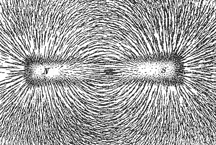

I was looking through a book on magnetism and it had the attached diagrams of field lines and stated that the classical diagram of field lines exiting the N pole and entering the S pole is incorrect. They claim their diagram is the correct representation of the magnetic field lines.
Their rationale is that if you take a long bar magnet, there is a strong magnetic attraction at the ends but very little in the middle.
But isn't this observation due to field gradients? That is, the field lines curve at the ends of a bar magnet and the field is strongly inhomogeneous, while at the middle of the bar magnet the field lines are almost parallel and the field is almost homogeneous.
Thank you.

The book is wrong. Read three others and take a majority decision!

It's wrong because the fields are not like that. It's a bit of a waste of time trying to find what's wrong about something unless you are trying to put someone right. Neither of us can tell the author how he's wrong so just ignore it. Presumably you can get a 'clear explanation' of the right description (any decent textbook). Maxwell's Equations do not describe it like that - see what they, correctly, predict. (http://www.sfu.ca/physics/associate/emeriti/cochran/MAX.pdf). If, like me, you would rather not go in that deep, just take it as correct.
The flaw is in how he's drawn the lines between the two intermediate poles. Why don't the lines go from the inner N to the inner S? If they do what the diagram says at that point, why don't they do it along the whole length of the magnet - wherever you choose to introduce a gap?
But the author IS trying to show that the fields are not like that! Isn't that what "Mistaken Concepts of Magnetism" accompanying the figure would imply?

Where did they go wrong? At the very beginning. You can easily see the field lines of a bar magnet by using iron filings.
Another question could be, why is there very little magnetic attraction in the middle of a bar magnet? This is what I was trying to draw out.

the weakest part of the field so to say is in the middle because fields of same strength but opposite poles comes together the same distance and cancel out , break the magnet in half and you get two new magnets each with a N and a S.and now the middle point is again between those two.

Here it is in black and white, see attached.
Yes, they go on and describe what subscribers to the Physics Forums would call the impossible and the implausible!

They simply can't get any more obvious than highlighting it in the TITLE of the chapter!
I still do not see what is wrong with this book. What you had described and shown so far seemed to reveal more of your misunderstanding of the authors were trying to do and show.

It's called "Magnetism and its effects on the living system". By Davis & Rawls. First published in 1974 by Acres USA.
It's not a textbook on physics and I think the disbelief that someone could have even published such nonsense has hijacked the original premise of my question.

The attachment had the tile "Mistaken Concepts of Magnetism". This is the name of the chapter.

Yeah, so? The figure they showed has the wrong magnetic fields, and this is consistent with the intention of the chapter, no? So what's wrong here?
Look, I'm going to say "A is wrong. Let me show you"
And then you complain that I showed you something wrong.
I then say "But wait, that's my intention! I TOLD you that I'm going to show you A!"
But you continue to complain "Yeah, but A is wrong! It can't be like that!"
I walk away and shake my head.
Zz.

Reading their rationale they also say that...
"a magnet has a magnetic equator and it is at this point where the spins of electrons change their phase relationship and present us two fields of energies and two different potentials of magnetic energy."
They say the magnetic energy leaves the S pole spinning to the right and dips to the centre (equator) of the magnet, then leaves the same location and spins to the left entering the N pole.
This is as shown on the first diagram I attached.
Supposedly (the authors say), the reason why field lines as shown by iron filings are misleading is because each iron filing becomes it's own magnet in the presence of the magnetic field.
