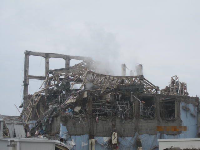

About explosions, I am not expert, I write only on base of observations: #1 explosion, big pressure in reactor building from venting then small, centered hydrogen explosion. #3 explosion, yest we can see it on video, first fireball from SFP location, then big explosion going up, but I don't think that it was from recriticality in SFP, I think that first explosion in SFP damaged drywell and reactor vessel so there was big release of pressure and maybe hydrogen explosion. If there would be so big explosion from SFP then there would be more very hight radioactive pieces of fuel rods, but they found only 300 and 900 mSv/h mayby from reactor cap... Also the big "up" explosion appear to be from center of building/core location not from sfp like fireball...

TCups said:
Question for Astronuc et al:
As I think about this, if the shape and depth of the SFP could focus the blast into a vertical mushroom, then the shape and depth of the SFP, particularly if there were water covering all or part of the spent fuel would also tend to focus the force of an explosion toward the bottom of the SFP. Might it be that either a blast from the primary containment or a blast from hydrogen + air in the service floor, "amplified" by the geometry of the SFP and efficiently transmitted by water in the SFP did indeed exert a hydrostatic, crushing force on the spent fuel assemblies?
This wouldn't be a shaped HE charge crushing two subcritical hemispheres of plutonium, but on a much larger scale, a large explosion crushing several tons of spent fuel racks -- at least in theory, the hypothesis of a sudden criticality in the SFP doesn't seem too far fetched to a lay person.
The fuel in the SFP is 'spent', in addition to the fact that is started with low enrichment. The available reactivity is low because it is 'spent'. The rate a which positive reactivity could be inserted is relatively low, so a prompt critical event is unlikely. Coming out of a subcritical configuration with a very low neutron source, rather than starting at a critical configuration, I don't believe the configuration in the SFP supports prompt supercritical.
The explosions at Units 1 and 3 occurred well before the pools would have dried out, and it is more likely the hydrogen came from oxidation of the cladding in the cores.
I don't see the explosions being nuclear.
If the pools had dried out, there certainly wouldn't be any moderator to allow criticality. If there was water covering the fuel at the time of the explosion, the pressure in the pool would have been more of an increase in hydrstatic pressure, and that would crush the fuel into a more critical configuration.
Re-criticality would have been a concern AFTER the hydrogen explosions, when they TEPCO was reintroducing water into the SFPs. However, I would have expected them to borate that water.
All I see are chemical (H2+O2) explosions, not nuclear.
