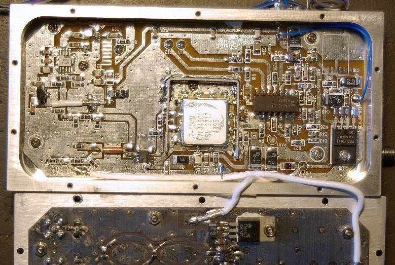

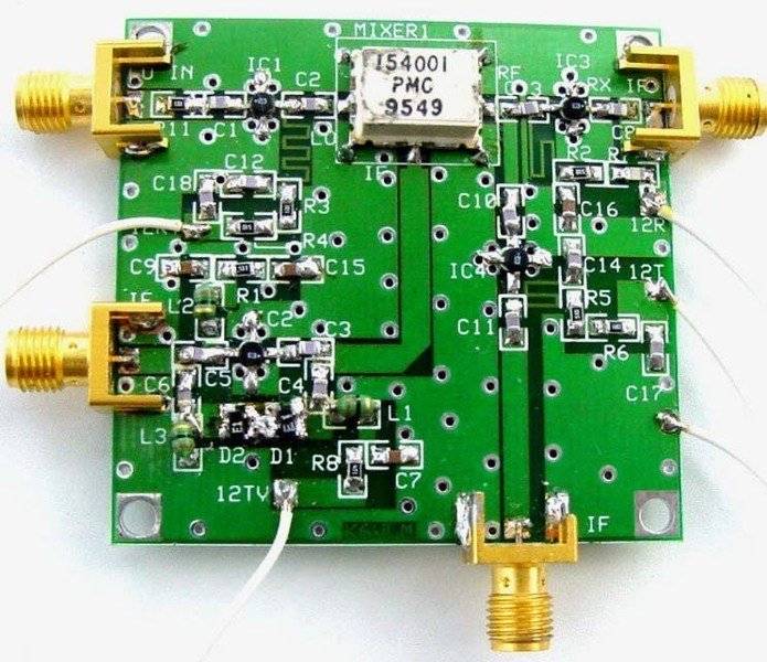

here's a pretty conventional way to mount SMA connectors on a PCB...
here's a pretty conventional way connect coax to a board ...
this is actually a 2GHz synth that I deal with
Teflon dielectric coax is the preferred type as you can solder all the way around the braid to the ground plane
cheers
Dave

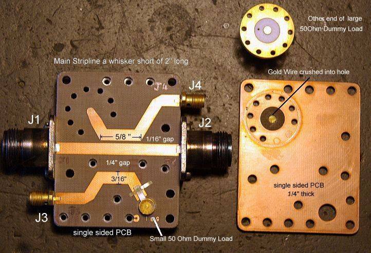

here's a really nice 2GHz directional coupler using both N type and SMA type connectors
big secret when soldering centre pin/flat tab of connector to the PCB track is to have as little
solder as possible... a process called "sweating". This is where you tin the connector pin and the track bring them together and heat then to the tiny amount of solder there melts and flows
there is absolutely NO EXCESS solder ... that is, no big blob/mound of solder
This becomes more critical the higher in frequency you go.
Dave
