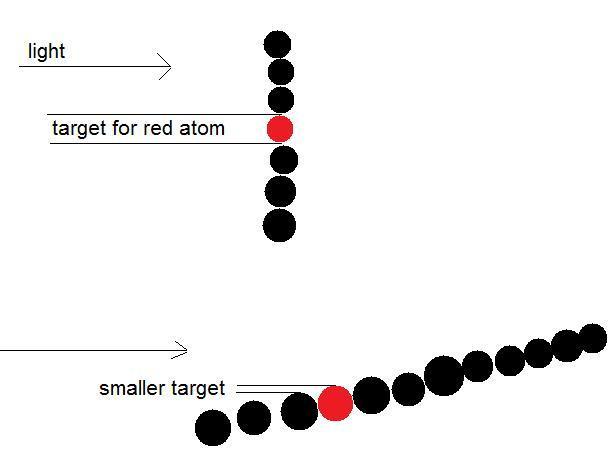

Let me try to illustrate my thinking. A quick caveat of sorts - I know that the power falls off in a strict relationship with distance, but I doubt it is a significant amount over the few thousand km represented by the distance from the Earth's equator to the pole. So I am assuming largely the same power of 1360 w/m2 in the following scenario.
Imagine a location at the equator of an imaginary blackbody sphere, and another location much closer to the pole, perhaps 2/3 of the way there. Now, remove the sphere. If we had one or more molecules at each of those locations, I would think they will each be affected by the sun's radiation in the same way, that is there is no special condition associated with the location of any of those molecules (or think of it another way - with no molecules present, how much power is 'available' in the radiation extant at those points?)
There is not 1/2 or some other fraction available to the one/s at the more poleward location surely? It is the same amount for all (remember we are disregarding the small difference due to distance).
Now let us return our imagined sphere to our mental model - why should the molecules at the same location which are now part of the sphere behave differently simply by being part of the sphere? Why is there now less radiation (power) available to those molecules?
Remember our sphere is completely absorbent, non-reflective, with no atmosphere. Does heating really occur at some macro scale when we have bodies larger than a few free-floating molecules? Or is it that radiation and heating are far more complex than I know about? That is certainly the case, yet the argument advanced is a simple one - the power of radiation and it's ability to heat, diminishes on a spherical surface as one moves further toward the 'pole'. And it is argued this is a geometrical effect.
I cannot see why that is so. Note I am not arguing against the fact, simply observing that when I think about it, it is not immediately clear to me why it is so.
Does that sketch help?
The number of photons which hit each atom per time is smaller in the second case.
If that does not help, I really cannot understand your problem.

Thanks mfb. Your diagram makes sense of course and it has helped me crystallize what it is that I have in mind. What your diagram illustrates is what would happen with a single stream of light in which all 'rays' are parallel. Then we would indeed have a discrete quantity of photons per unit area and as we tilt the target and in effect make the target area smaller it receives a smaller number of photons in total.
