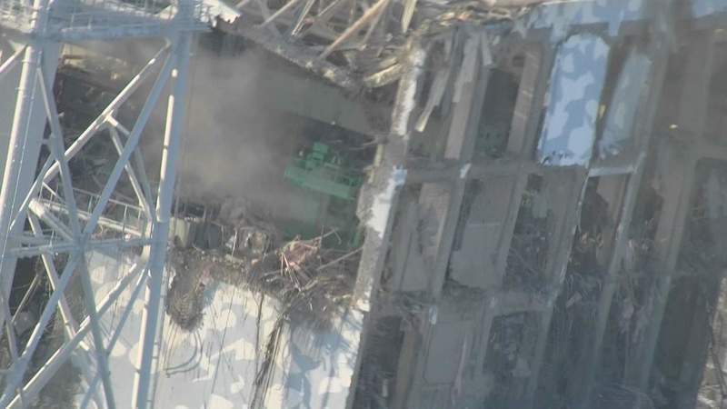

Here is another crop of the northside of #3.
I am as sure as I can be, that the side was blasted out - and my best shot is that the blast originated from the equipment pool.

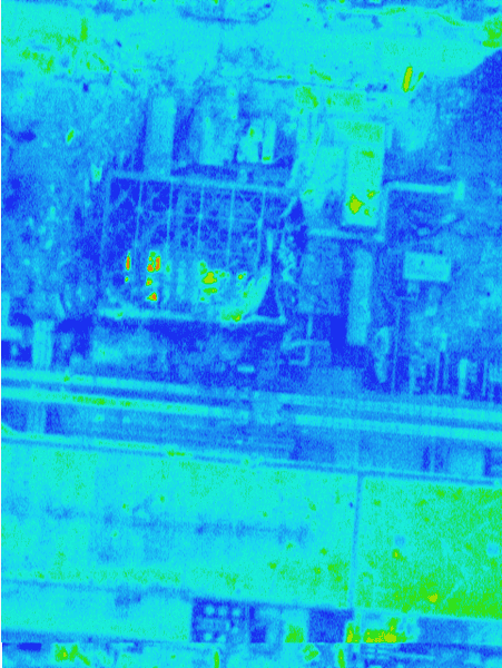

Ms Music: I double checked and you are right on one thing: the supposed fuel rods on the roof was a place at No3 reactor, and not No4 as previously stated.
But I think the resolution on the Hi res picture is still not sufficient to see such small sticks. I did a capture that puts precisely right in the middle the place where the supposedly "fuel rods" are seen on the video, it was close to these green spots. The rebar was more on the lower left side of my screenshot.
http://www.netimago.com/image_184819.html
To me it is impossible to decide if they are there or not. But i confirm that this would be a strange place to be for a fuel rod as the SPF is on the other side.

gmax137 said:
That looks like a bunch of 3/8 inch stainless tubing to me. There's typically miles of that stuff in a plant, used for instrumentation.
Joe Neubarth said:
It does not to me.
I see rumpled elongated narrow sheets that were made that way by physical shock, like from that explosion.
They appear to be (approximate guess) ten times to fifteen times wider than they are thick.
For them to have taken on such a rumpled shape their substance must have some malleability, much like lead.
What ever fits that description is what it is.
I think they are fuel rods that have been through one hell of an explosion.
But what the hell, I am not a nuclear engineer. I just go by what my eyes tell me.
