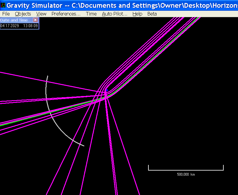

  • #44
But the point bassplayer142 was making was that if you detonate it early enough, none of the pieces will hit the Earth. They will all be so spread out in their orbits that their average spacing will exceed 1 Earth diameter.
Here are some screen shots of a simulation I performed. One year prior to Apophis' 2029 collision with Earth, I created a 2nd Apophis, about 200,000 km from the real Apophis, placing it on a collision trajectory with Earth. I then shattered it into 20 pieces. Each piece had a velocity of 1 meter per second relative to the original object.
After 1 year, a battery of Apophiss approaches the Earth and Moon. The green one is the real Apophis. The gray path is the orbit of Moon.
8 of them impact the Earth, while 12 miss. This shows the incoming and outgoing trajectories of the 12 surviving pieces. The green one is the real Apophis.
(why don't image tags work in this sub-forum? The Homework Help section let's you use img tags.)
So the moral of the story is either nuke it with enough force that the pieces spread faster than 1 meter per second, or nuke it more than 1 year in advance.
