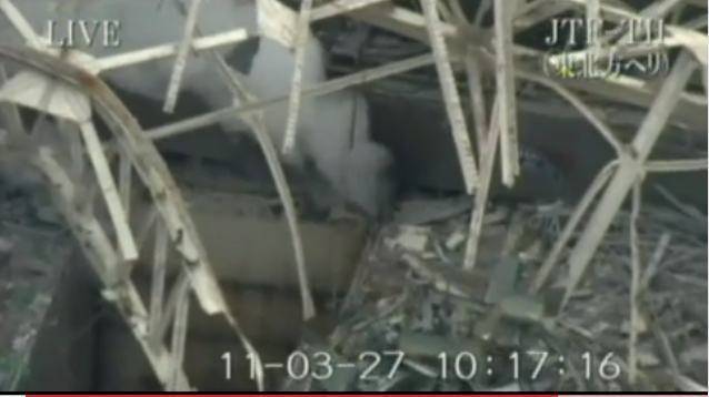

MadderDoc said:
Apparently 'hydrogen explosion' can be used to explain any effect, any degree of damage, and is not supposed to be held to any high evidential standard. Otoh, if there is just a few patches of something looking like paint to be found on a piece of scrap metal, it is concluded that it cannot have been damaged by heat. I wonder if you'd seriously be willing to use that criterium, if you were shown corroded beams with not a speck of paint left, or 'hydrogen explosion' and a bit of handwaving would be used to explain that away too.
I am not saying there was no heat involved. I am saying that the blast bent and scoured those beams. IOW, some of the superficial damage that you see (rusty bits where paint used to be) is caused by heat. The sagging and twisting, it's because of the blast and (afterwards) gravity.
Please, don't tell me you believe those beams were melted into that position.
I mean, sure, there is enough energy in a ton (or even half-ton) of hydrogen to do that. But how was it done? Those beams were not melted one by one with a H-O torch. They were blasted. You can see the blast yourself. Why do you find it hard to believe that it could have bent and twisted steel? Do you not think a pressure spike of 1.5-2 MPa (at least, much higher if reflected) could have done what we are seeing?
Take a look at this, please.
http://www.hysafe.org/download/1009/BRHS_Ch3_Consequences_version 1_0_1.pdf
Perhaps. You are not being very specific, I much prefer to be working from evidence.
I think it is fair to say that the roof construction of Unit 3, or what remains of it is _not_ uniformly damaged, and in that context the SE corner of the construction stands out as being in particularly worse shape. Also it appears to be damaged in ways or degrees we do not see elsewhere. While most parts of the roof construction could well with some mechanic work be reconstructed reusing most pieces, the SE quadrant looks like a scrap the lot job (or whatever of it you can identify) and do a total rebuild.
Likewise, looking at the east wall, or what remains of it, it is not uniformly damaged. The south half of it is the more damaged part. Within the north and the south sections otoh, the damages share a common pattern, as regards e.g. discoloring and concrete matrix degradation. In the north section the roof construction has neatly come unplugged from its sockets on the pillars. In the south section the complete top layer of the pillars with the sockets come off in pieces, and it is not at all clear that anything there became neatly unplugged.
Then of course there is the video evidence, which again indicates a peculiarity, a prominent fire phenomenon, linked to the SE corner of the building.
To be sure 'hydrogen explosion' can go a long way to explain the damages to Unit 3, in general terms. And there are some knobs one can screw on. More hydrogen, more flame front speed, its all on the shelves for the picking. But, what does it do to explain the peculiarities? High on my wishing list would be the explanation of the peculiar damages to the SE corner of the building and its curious coincidence with the peculiar fire phenomenon above that corner, one of the hall marks of the Unit 3 event. While of course the peculiar mushroom cloud and its curious coincidence with a pressure drop in the reactor tops the list..
