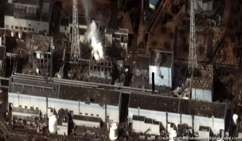

IF the rods in the pool were perhaps not fully spent. . . for example, Unit 4 were shut down for maintenance, and all the fuel rod assemblies removed from the reactor core (and therefore removed from the primary containment) and IF, instead, they were in the SFP outside of the primary containment . . .
THEN, could loss of circulating coolant surrounding the rods in the SFP result in heat sufficient to boil off the remaining water, oxidize the Zr-2 cladding, generate steam + hydrogen + fires, burn through the floor and sidewall of the "dry" SFP, and "blow out" the side of the Unit 4 building?
Look where the photo (I hope it was a remote robotic taking the picture) is centered. What do you think they were assessing? Does it look to you like there is a "slag-like" tongue of something hanging out of a relatively square hole in roughly the location that might correspond to the SFP, and that a sideways blast has taken out some of the structures external to the building as well as the roof of the building?
http://www.abc.net.au/reslib/201103/r735227_5964756.jpg
The damage from explosion at Unit 4 is fundamentally different than that at Unit 3, where all the structures seem to be blown out away from the primary containment.

The spent fuel pool (3) is outside of primary containment. It sits on top of the concrete structure. Each fuel assembly sits in a square tube in a rack. The rack has neutron absorber material to prevent criticality. The water covering the fuel provides cooling and shielding. The concern is that the water evaporates, and exposes the fuel to air. The oxgyen in the air then oxidizes the Zr-2 cladding, which produces hydrogen. The question then is what caused the fire at unit 4? If it was hydrogen deflagration (not an explosion) - then what is the source of the hydrogen? If there is no fuel in the reactor vessel - it may be that it is coming from the SFP, which has already dried out. Could there have been other sources of hydrogen? Perhaps if the plant uses hydrogen water chemistry. Could there have been other sources of fuel? If so, what?
If fuel is taken from the spent fuel pool and shipped out of the reactor building, it would be do so in a shielded cask, which is shown in the picture. The cask contains several assemblies (~28 perhaps), and it is filled with He for cooling. Even so, the casks can get pretty hot. Smaller shipping casks, which hold fewer assemblies, do not get as hot as storage casks. The oldest, coolest fuel is put in storage casks if there is insufficient room to store all discharged fuel + a full core's worth.
Units 1 and 3 had significant explosions, whereas unit 4 may have had a smaller explosion or fire. Or, was it damaged by the explosion and fire of unit 3?
I expect they are trying to assess the damage to unit 4 and how they might get water to the spent fuel pool.

Taking a closer look into the square hole, I wonder if portions of exposed spent fuel rods might be glowing red?

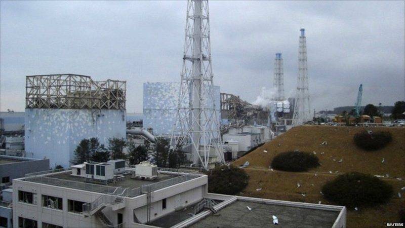

Well, here is my "radiologist" interpretation of this image
PS: Borek - someone posted this reference a day or so earlier. Look down the list and check out the "Spent Fuel Integrity" status. Neither "no info" nor "temperature rising" are that reassuring to me. Also, note that seawater injection into the reactor vessels of units 4, 5, 6 was "not necessary" -- because perhaps the fuel rods weren't in the reactor vessel? Don't fuel rods, once they have "reacted", wherever they are, and in whatever state they are in (spent, or otherwise) require ongoing cooling? I believe so.
http://www.jaif.or.jp/english/news_images/pdf/ENGNEWS01_1300189582P.pdf [Broken]

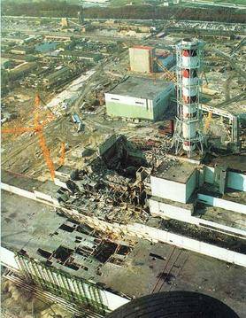

All of that said, including the sarcasm, this is still nowhere near the level of the Chernobyl disaster where a critical graphite pile with no primary containment exploded and burned for days because of gross incompetence.
It seems to me that there were no fundamental operator errors immediately apparent in Japan's "event" -- the 40-year old systems worked as well as they could for as long as they could under the circumstances. Pretty sure someone will have to be found to blame, eventually, though. They always are.

I see some of this has been answered so I apologize for the rehash but...
Astronuc or others with knowledge of the issue: I'm trying to assess how bad it is and could be compared with Chernobyl. Could you please comment on my understanding of how they compare:
1. The explosions in Japan have been steam and/or hydrogen explosions. Chernobyl's explosions were steam and likely a small nuclear explosion.
2. The explosions in Japan have destroyed the reactor buildings, leaving the reactor cores mostly intact due to their containment structures. The explosion in Chernobyl destroyed the reactor core due to the lack of containment, ejecting the core material itself into the surrounding area (and air).
3. The explosion combined with burning graphite remnants of the destroyed core is what released most of the radioactive material into the environment at Chernobyl. Most of the radioactive material released into the environment in Japan thus far has been carried by semi-controlled steam releases and uncontrolled steam explosions outside of the reactor core, neither of which can carry anywhere close to the quantities of radiactive material that were dispersed at Chernobyl.
4. The primary ongoing risks in Japan are the continued release of steam carrying small amounts of radioactive material and the potential for groundwater contamination due to cracks in the containment vessel and building foundation. Direct ejection of large quantities of core material is unlikely due to the containment vessels (Q: Is a "nuclear excursion" - a small nuclear explosion like at Chernobyl - a possibility here and could it destroy the reactor core containment vessels?).
5. Chernobyl had physics flaws that made it more difficult for the operators to stop the accident once it started (such as positive feedback loops leading to run-away increases in output for counterintuitive reasons). Japan's reactors contained an external safety flaw in the backup power systems that made it impossible to stop the accident. Q: Does the reactor physics that helped cause the "excursion" in Chernobyl exist in any form in Japan's reactors?
