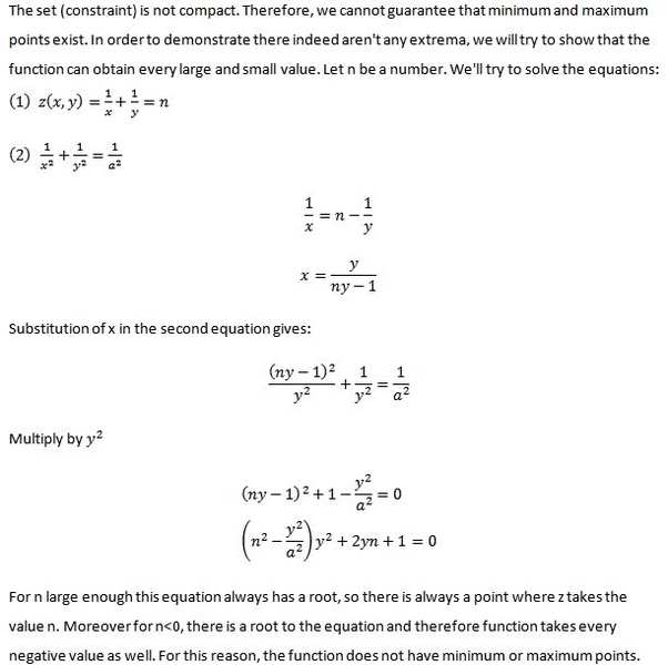

I have solved this problem by using Lagrange multipliers.
However, the answers that my teacher has published, say that the solution to the Lagrange system of equations is neither minimum nor maximum because the function has no extrema.
Proving that this function does not have extrema is the part where I am stuck.
Here is the solution posted by my teacher (sorry for my English):

Here is another twist on the problem. Assume throughout that a > 0. Suppose we look at [itex] X = 1/x, \; Y = 1/y.[/itex] Now the problem is to maximize or minimize [itex] z = X + Y,[/itex] subject to the constraint [itex] X^2 + Y^2 = 1/a^2.[/itex] The constraint region is a circle of radius 1/a centered at (0,0) in (X,Y)-space, and in this problem the GLOBAL max occurs at [tex] (X,Y) = \left(\frac{1}{a\sqrt{2}},\frac{1}{a \sqrt{2}} \right),[/tex] giving [itex] z_{\max} = \sqrt{2}/a, [/itex] while the global min is at
[tex] (X,Y) = \left(-\frac{1}{a\sqrt{2}},-\frac{a}{a \sqrt{2}} \right),[/tex] giving
[itex] z_{\min} = - \sqrt{2}/a.[/itex] Since these optimal are global, it is absolutely impossible to have (X,Y) giving z > zmax or z < zmin.
Your posted solution given above contains errors. The correct equation for y should be
[tex]\left(n^2 - \frac{1}{a^2} \right) y^2 - 2ny + 2 = 0, [/tex] which does NOT have real roots for [itex] |n| > \sqrt{2}/a.[/itex]
RGV

You are right. I will notify my teacher.
However, when you take [itex] X = 1/x, \; Y = 1/y.[/itex], can you really say it's a circle centered in (0,0)? X and Y cannot be equal to zero, therefore the constraint is not compact, so you cannot guarantee the existence of global extrema.
Wrong. In (X,Y) space the function to be optimized is X+Y and the constraint region is a circle centered at (0,0). Of course I am allowed to have X=0, but such an X is not the reciprocal of a finite x. Do not confuse two separate issues: SOME X and Y are related to finite values of x and y, but I am allowed to look at other values of X and Y as well.
Also: do not ever assume that a continuous function on a non-compact set lacks maxima or minima. Compactness is a _sufficient_ condition for existence of a max or min, but it is not a _neccessary_ condition. Many smooth functions on non-compact regions have both maxima and minima.
RGV
