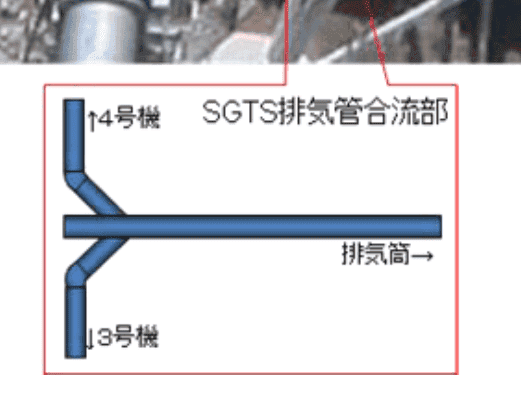

Irrespective of the exact cause initiating the steam explosion, an open connection from the primary containment of Unit 3 to the contents of SFP3 seems to be supported by the water analysis, right?
