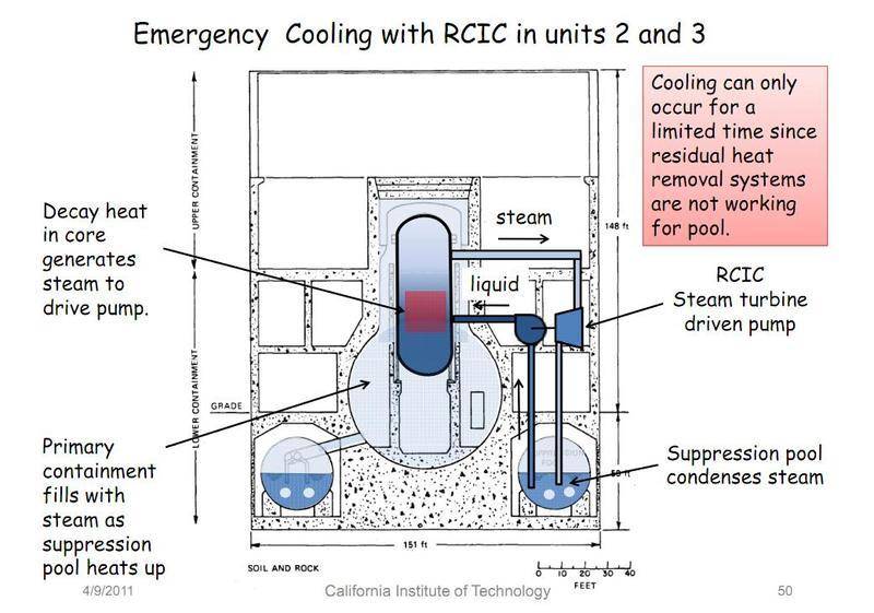

elektrownik said:
Reactor is source of steam, then steam is going to turbine, this turbin is connected to pump, water source is torus, pump is pumping water from torus to RPV and steam which go to turbine is condensated in torus.
http://a2.sphotos.ak.fbcdn.net/hphotos-ak-ash4/188425_211896475487877_113650851979107_876237_7212984_n.jpg
In normal lineup RCIC initially pumps water from the clean condensate storage tank. Suction can be switched to torus, but that is not the first choice.
