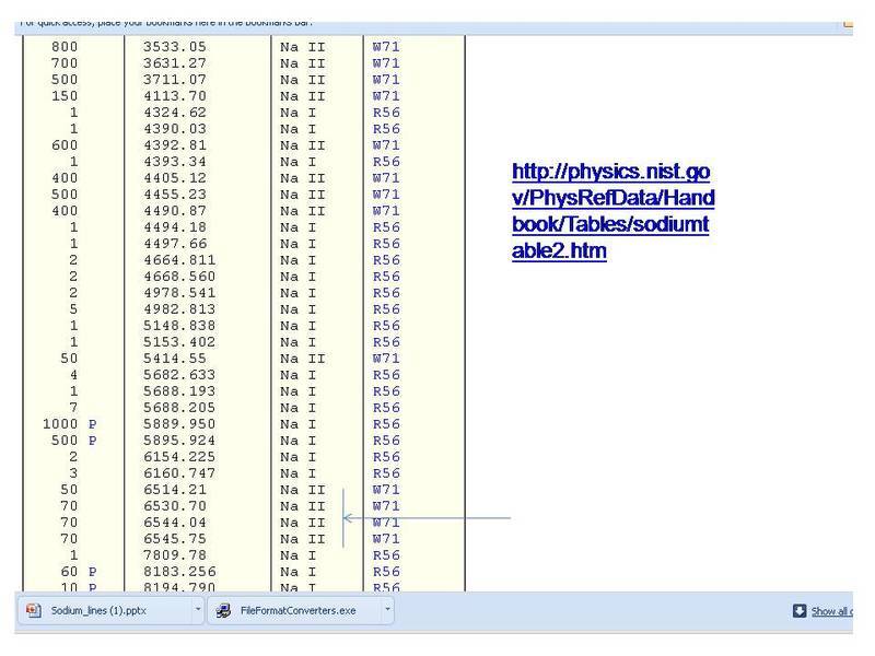

I was doing an undergrad experiment on the sodium emission spectrum and I have a few queries. Of course, I was asked to analyse the famous yellow doublet which I'm on top of. I was also asked the analyse the diffuse series which was fine too.
What I did notice however, was a strong red line that wasn't in the diffuse series. I was told to do somme research about its origin but I've had absolutely no success in finding any information online or in books yet. It seems that most information online just focuses on the bright yellow doublet.
This wavelength wasn't even measured and I can hardly be expected to go through every possible energy difference and try to find the one that's the best match. There must be an easier explanation.
We were also given, for the practical task, a list of transition levels. That got me wondering - why are there so many omissions? I was again told to do some research, specifically on why there aren't transitions between the s and d series. I was thinking of something along the line of not conserving spin etc but I can't quite put my finger on it.

I used the database. I did a search between 6200 Angstrom and 6500 Angstrom, the smallest wavelengths in the red section. I got stacks of answers though. I have no idea what to pick. In the diagram that I have, it simply has 1 red wavelength labelled that I was asked to research, as if it's particularly special.

(See my post above on NIST Table) There are four red lines between 6500 and 6700 Angstroms belonging to ionized (missing 1 electron) sodium. There is nothing in un-ionized sodium in this range.
Yes there are. None of these lines are labeled "persistent" and none of them has a particularly high intensity. The OP says he/she is looking for a strong line. Hence my question.

Here is a high pressure sodium spectrum from www.umd.edu[/url] in the first attachment, and a listing of visible sodium lines from [url]www.nist.gov[/URL] in the second attachment. In the sodium spectrum, a triplet of red lines is visible. In the NIST table, a quartet of red lines near 6500 Angstroms from ionized sodium are shown. Three of the red lines in the Table are spaced at about 15 Angstroms, and the fourth is only 1.7 Angstroms away, and is probably not resolved. The three red lines visible in the spectrum are probably the three lines listed in the Table.

Bob, that was the wrong explanation a year ago when you first posted it, and it's the wrong explanation now. He's looking for strong lines, and the lines you have posted are weak.
High pressure sodium is irrelevant. He says he's studying the D-lines, and you have pressure broadening in high pressure sodium that makes this impossible - indeed, there you can have emission in the red: the D-lines can get that broad.
Sodium does not have any strong red lines. However, a sodium vapor tube can have all sorts of other things in it. Mercury, argon and neon are all commonly present. Before trying to figure out why an element without strong lines in the red somehow has strong lines in the red, wouldn't it make sense to ask what exactly is in the tube? And indeed, wasn't the reason spectroscopy was developed to answer the question "which elements am I looking at"?
