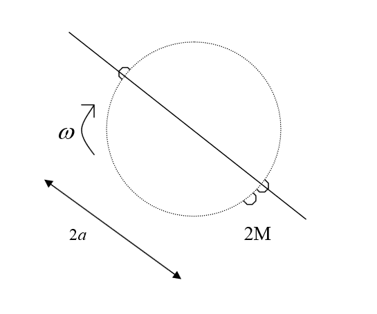

Two masses of similar mass M are connected by a rod of length 2a. the rod is rotating on a horizontal plane in an angular velocity of ω, when its center of mass (point A) is at rest. The table is horizontal and friction is neglected. (the rod is not wired to the table).
At some given time t, we locate a mass of 2M so that it sticks to one of the masses.
Question:What is the angular velocity that the rod will rotate in around its new center of mass after the collision?
What I did was this:
1. I calculated the location of the new center of mass (the after frame) and it turns out to be a/2 towards the 3M.
2. I looked at the frame just a moment before collision so that the mass 2M is really close to the mass M (one of them) but yet to collide with one. I calculated the angular momentum before collision by I*ω around the new center of mass that I stated above:
[m*(3a/2)^2 + m*(a/2)^2]*ω = 2.5m*(a^2)*ω
3. Now, I looked at the frame just a moment after the collision so the masses pretty much made no movement and again I calculated the angular velocity after collision by I*ω around the new center of mass:
[m*(3a/2)^2 + m*(a/2)^2 + 2m*(a/2)^2]*ω' = 3m*(a^2)*ω'
4. Of course there is conservation of angular momentum, therefore I equalized the two expressions to get that the new angular velocity is ω' = (5/6)*ω and not (2/3)*ω as the correct answer is.
Here's the thing that's bothering me other than that answer is wrong. I tried applying RxMV on the before system with the location of the new center of mass and it turns out to be right!
I really don't understand where have I mistaken in the solution I've given and why in A LOT of cases when I do I*ω and RxMV in this type of questions (conservation of angular momentum) I get different results. I thought they're equal...
Anyway, I'd really appreciate it if you guys told me at which point of the solution I did an incorrect step and also answer my question in the last paragraph.
THANK YOU!

Like I mentioned in my previous post, since they say that the initial rotation is with respect to the center of the rod, you must use that information to find the initial angular momentum. Therefore it is
[itex] (m a^2 + m a^2) \omega = 2 m a ^2 \omega [/itex]
Set this equal to your final angular momentum and you will get the correct answer.

At last I see where we both went wrong. We calculated the prior angular momentum wrongly. We did it as though the rod were rotating about the system CoM. Instead, look at the linear velocities. Each mass has speed aω, so the moment is maω(3a/2 + a/2) = 2maω2.
I don't believe it's right to say that each has a a linear velocity of what you said. The linear velocity of each mass is v=ωxr where r is the distance from the location of our new center of mass to where the body is and then you apply rxmv where r, again, is the distance mentioned above.
What you've done is calculate the linear velocity of each mass with respect to the point they're rotating around before colliding with the 3rd mass.
Nrqrd is right.
The initial linear velocities were v and -v, where v=aω, as the rod rotated about its centre.
The angular momentum of a point mass about any fixed point is mrxv. That of the system of the rotating equal masses, with respect to the centre of the rod, was 2mav=2ma2ω.
The angular momentum in the new frame of reference was (3/2 a ) v m + (1/2 a) v m= 2avm again as orodruin pointed out in Post #11.
The 2m mass was added to the system. Originally in rest, it had zero contribution to the angular momentum. After it stuck to the bottom mass, the angular momentum became IΩ where the moment of inertia I=m(3/2 a)2+3m (1/2 a)2= 3 a2m .
The angular momentum is conserved:3 a2m Ω =2ma2ω.

The angular momentum is conserved:3 a2m Ω =2ma2ω, The new angular speed is 2/3 of the initial one.
First off, thanks for the solution you've posted.
I've posted a question about the linear velocities. Can you please take a look at my last post (#16)?
Thanks.
My post was the answer to your Post #16. Just before the collision, the linear velocities of the masses were v and -v, in any rest frame of reference. The velocities do not change if you change the point of reference. v=rω is valid if r is measured from the centre of rotation, and it was at the middle of the stick before the collision.
