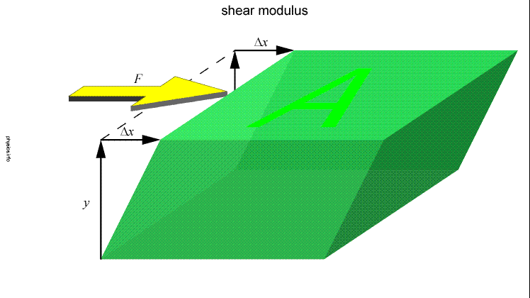

my geophysics lecturer at university would have severely debated that with you
and would have give you the inverted jug of beer experiment to prove otherwise
if a fluid could support shearing then why do shear waves not travel through it ?
it just doesnt happen, Shear modulus of a fluid = 0
shear modulus
Shear Modulus (S) also known as the rigidity modulus
Gases and liquids can not have shear moduli. They have viscosity instead.
http://physics.info/elasticity/
Dave

Who said anything about gasses and liquids supporting shear strain? You do know the difference between stress and strain, correct? The OP was asking about shear stresses in a liquid, and how they contribute to pressure drop. Either your lecturer didn't know much about fluid mechanics, or you misinterpreted what he was saying. Viscosity is precisely what we are talking about here. This is the fluid property that allows a fluid to develop shear stress. I hope you really didn't think that shear stresses could only exist in solids. In a liquid, the shear stress is proportional to the rate of strain, rather than the strain itself.
