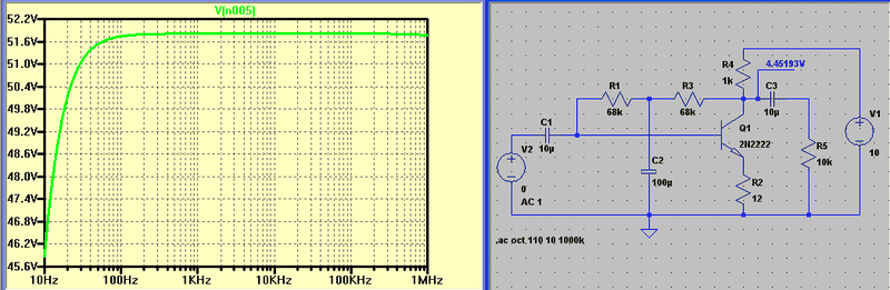

Read the bias scheme in Malvino. Re2 is to stabilizing the collector current. This is called voltage divider bias. R1 and R2 form a voltage divider to give about 1.7V at the base. The emitter is about 0.7V below so the emitter is at about 1V. You have Re1+Re2 about 200 ohm ( don't be picky), so you are setting up the emitter current ( collector current) of about 5 mA. This 5 mA will give r'e ≈ 5 ohm. The point of using voltage divider bias is to control the current through the BJT by the voltage drop across the Re2. This make it a lot more predictable. Read Malvino, it's all there.
The C2 is to bypass Re2 at frequency you want to amplify. At high frequency, Re2 is being shorted out by C2, so the resistance on the emitter side is r'e+Re1=19 ohm or 20 ohm.
No matter how the circuit looks like, in common emitter BJT circuit, the gain is the total impedance at the collector divided by the total impedance at the emitter. AND it is inverted. It is just that simple.
