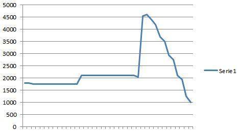

Reactor 3 temperatures
Higher cooling rates do not tame temperature rise
With the bottom head temperature now at 152oC and showing a constant rate of increase, surely indicates that something very hot is lying in the bottom of the reactor that is not cooled by the water above it. This temperature sensor and the HVH sensor are the two sensors that Tepco have high confidence in as it is not marked #3 (under investigation)
[PLAIN]http://k.min.us/ilrAJa.JPG
From current data: http://www.tepco.co.jp/nu/fukushima-np/f1/images/00_05080600.pdf we can see that water level drop litle once again.
[PLAIN]http://k.min.us/ilrAJa.JPG[/QUOTE]
water is not only a coolant, but also a moderator and a washer-out of boron.
By now they really should've already gotten the on-site lab to analyse samples right away to check for short living isotopes. They were offered such stuff, but of course for them to take any nuclear accident - specific equipment is to admit that failure to have their own has contributed to disaster.
They are checking for La-140 (40 hours halflife) and monitoring neutron detectors, according to IAEA Miroslav Lipar.
http://www.slideshare.net/iaea/technical-briefing-11-0505
