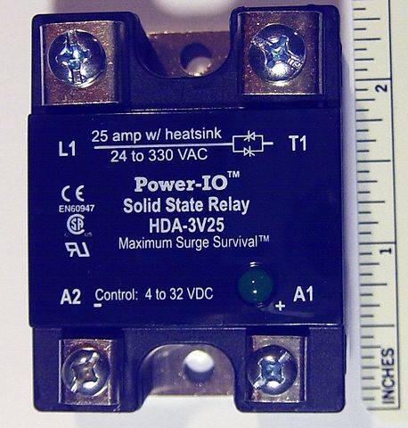

I would like to be able to control the temperature of the plug heaters so that I am able to set a maximum temperature, which is held for a period of time before shutoff. Nothing overly elaborate. There will be no other electrical components, just the plug heater and the thermostat controller.
I'm not clear on how controllers of this type work. The output for the controllers is either DC Pulse, Relay, or 4-20mA (is up to the buyer). For my described application which output would be the simplest? What additional hardware would I need for what is suggested?

-No, you don't need an additional power supply. You can wire it directly to a 100vac to 240vac source with the line on terminal 11 and the neutral on terminal 12 (see page 6 of the Omega bulletin).
-The Short Cartridge Heaters can be bought for either 120vac or 240vac operation so you would need to supply that through a relay output as opposed to a dc pulse which would not drive the heater.

I had a feeling that the heating elements would have to be connected through a relay, rather than the DC pulse.
You could use dc pulses as a input to a Solid State Relay that switches the ac to the heater however. Depending on the wattage of the heater you chose determines at what current rating you would need for one of these:
