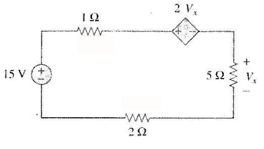

Find [itex]V_x[/itex] in the circuit.
[itex]\displaystyle{\sum V_i=0}[/itex]
I tried to add all of the voltages and label the 2 ohm res V1 and 1 ohm res V2.
Then I did:
[itex]V_x+V_1-15+V_2+2V_x=0[/itex]
[itex]3V_x+V_1+V_2=15[/itex]
but then I couldn't find any other equations that will aid me in solving this.
I'm not really sure if I really need the V1 and V2.
The circuit doesn't give you the current either, so I don't know why resistance would help.
Thanks.

Welcome to the PF.
Where did you come up with those equations? There is one current around that loop that generates the voltage drops and controls the voltage controlled current source. Could you please try writing the one equation for the loop again, and solving it?

Is this right?
[itex]i[/itex] is the current
[itex]\begin{align*}
2V_x+V_x+2i+i&=15\\
3(5\cdot i)+2i+i&=15\\
i&=\frac{15}{18}=\frac{5}{6}\;A
\end{align*}[/itex]
[itex]V=I\cdot R=\frac56 \cdot 5=\boxed{\dfrac{25}{6}\;V}[/itex]
Also, current is the same throughout in a series circuit right/

The diamond source is a voltage controlled current source, right? Not a voltage...
Correct.
Upon further review, and input from another Mentor, I may be wrong about the controlled source. It looks like a current source to me, but I could be wrong about that. It may be a voltage controlled voltage source (VCVS) instead. Sorry if I mislead you on this.
