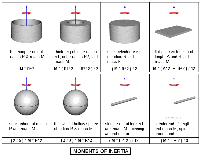

You also have another possible problem with the formula for mass moment of inertia of the dynamometer drum.
Assuming the drum is a hollow cylinder, the MOI is given below:
MOI = (m/2)*(Router^2 + Rinner^2)
It's counterintuitive, but accurate

that's the same MOI I posted isn't ?, the drum is a hollow cylinder. the first equation in my post I=1/2*m*(r_{1}^{2}-r_{2}^{2}

Look carefully at your formula for MOI versus what is in my attachment:
Your formula has the difference of the radii squared. For a hollow cylinder, the MOI is proportional to the sum of the radii squared.
thanks, I need to double check my posts, fortunately the equation in my spread sheet is the sum and not the difference.
