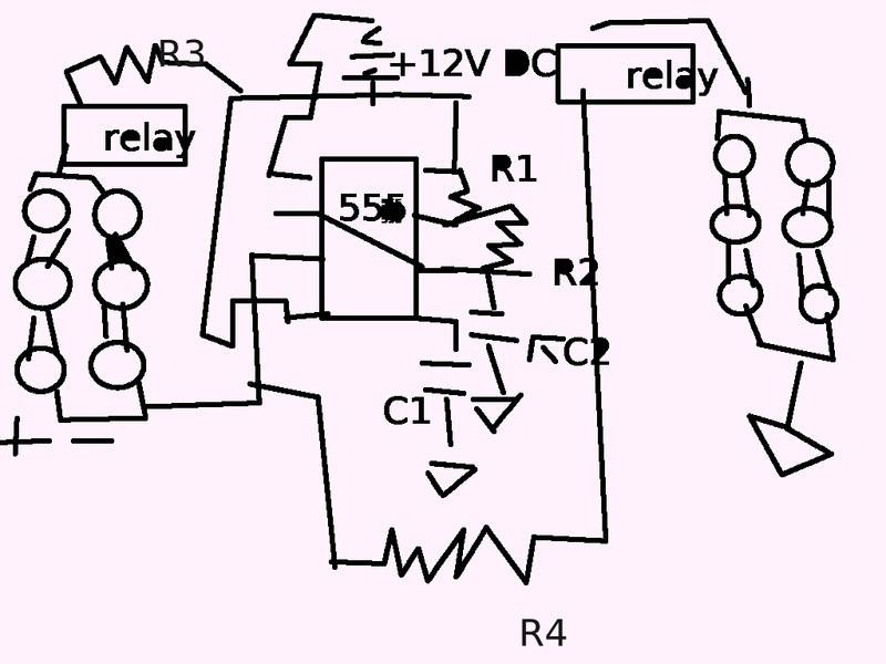

Hi, I have a circuit that I am working on that I adapted from the 6v version here http://electronician.blogspot.com/2009/09/555-timer-project-15v-led-flasher.html I have a 12v supply with a total of 48 leds 24 on each bank. I have gotten previous version to work with single leds but now that I have added more only one bank lights and it stays lit without ever flashing. I have found on info on other sites that prompted me to to put relays in where the output goes to led. Any help would be greatly appreciated.

I do have the leds in parallel and I have gotten this to work on the breadboard fairly nicely, but when I soldered it all onto a chip it stopped. I've checked and rechecked solder joints but I cannot figure out what changed.
Btw they are 20 mA leds that use 3.3v forward. used a resistor calculator online to decide on the resistor values leds are getting enough power but seems to me that no pulse is coming from the 555 but that's just a student's impression
Maybe you could draw a diagram of what you are using? Just use MS Paint if you have Windows XP or draw it on paper and take a digital picture of it. Reduce it to under 100 K first, though.
See the little paper clip thing at the top of the edit screen? You can use that to attach a picture or a drawing.
Try to simplify your circuit and see if the 555 can switch ONE LED, then two, then three, etc.
It might just be overloaded.
Hello,
Although my paint skills are not the best I hope this helps.
Where:
C1 = 10uF
C2 = 0.1uF
R1 = 82 ohms
R2 = ! MegaOhm Variable Resistor
R3 = 150 Ohm
R4 = 150 Ohm
Six LED's in each bank,
Each LED specs are 20 mA and 3.3V
Thanks for trying with Paint.
Here is how you could use relays to switch the LEds:
[PLAIN]http://dl.dropbox.com/u/4222062/led%20switching%20with%20relay.PNG
Your diagram does not show you doing it like this.
Note the diode across the relay coil. This is to protect the driving device from spikes in voltage due to the coil.
The diagram on the right shows a transistor driving the relay if the 555 could not manage it.
The 555 output, or the transistor, only drives the coil of the relay. The LEDs are switched by the relay contacts.
The original circuit used a single 555 to switch both banks without relays, I added them after I boosted the voltage and I did have diodes on the relays but when they were in nothing light up. at least without them one bank lights
You have the relay in now, so can you hear it clicking?
Relays normally make a noise when they switch on or off. If yours isn't clicking, your 555 may have blown up or the diode might be in the wrong way around. The diode should not affect the normal operation of the circuit.

It clicks when power is switched on but not again. leds light when battery applied. What am I looking for if the ic is bad, or how can I test it.
I cut leds to just one per relay still just one led lit steady. I measured output pin with voltmeter reading close to -12v steady. I don't know if that wil help you or not.
The relay is not being switched.
With one end of the relay coil connected to 12 volts, disconnect the other end of the relay coil from the 555 output and connect this end to ground briefly. Does this cause the relay to make a clicking noise?
Do the LEDs turn on when you do this?
