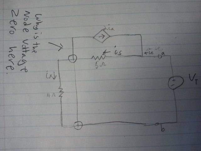

I don't understand why the node voltage here is zero(this is for circuits class)
In summary, the teacher was going over a thevenin and norton circuit and he was trying to find Ix. He was confused when he did the node voltage at the 2 circled nodes to find Ix. He understood why the bottom node would be zero because it is the reference node but why is the top one zero? He has uploaded a picture of the notes and circled the node where he needs help with. Since it is connected to Vt wouldn't it have some voltage? Haven't you shown both nodes connected directly together? The circuit can be redrawn like this. Can you explain why the voltage at the node is zero and why the current running through the resistor is zero? Can anybody help me? Are you sure
bambam123456
My teacher was going over a thevenin and norton circuit and i understand the thevenin and norton part of it, but the part that confused me was when he did the node voltage at the 2 circled nodes to find Ix. I understand why the bottom node would be zero because it is the reference node but why is the top one zero. I have uploaded a picture of the notes and circled the node where i need help with. Since its connected to Vt wouldn't it have some voltage?

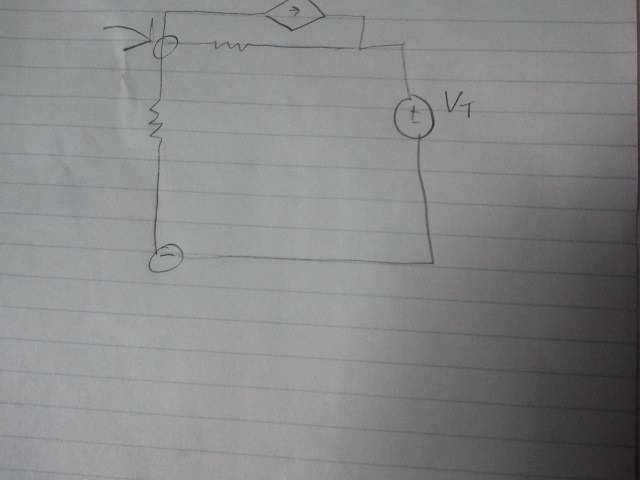

the circuit can be redrawn like this. Can you explain why the voltage at the node is zero and why the current running through the resistor is zero?

Are you sure that bottom one is reference node?
Can you please post a full problem. I have little to work with here, and I cannot see everything clearly. Post the original schematics with variables etc.
bambam123456 said:
can anybody help me?
If the "bottom node" is the reference and if you remove the apparent short circuit that you had in you first diagram then yes you are correct, the voltage at that node is not zero (unless VT=0). It is in fact [itex]4 V_T /19[/itex].
how sure are you about your sketch?
i observe Vt's polarity is + up.
I observe the current source's polarity is + right so they oppose.
I can't read what is value of current source - is it 2ix ?
If so, write KVL around circuit
start at bottom of vvoltage source go ccw
-Vt + 5i5 +4ix = 0
and KCL at upper circled node
i5 -ix -2ix = 0
which yields: i5=3ix
plug into KVL equation
-Vt +5(3ix) +4ix = 0
Vt = 19ix
ix = Vt/19
