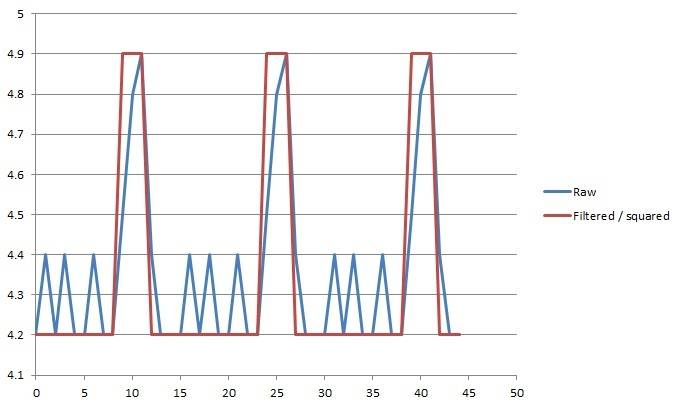

I have a data signal that I'm looking to reduce the noise in. I'm recording voltage at 12000hz and am getting high frequency noise induced by nearby power supplies in the lines that I am using. The noise amplitude is approximately .2-.3 Volts and the signal I am trying to get out has an amplitude of approximately .8-.9 volts. The baseline hovers around 4V (so when a sample is detected at the sensor, it jumps up to ~5v, then back down to 4V when the sample leaves the sensor, samples only last at the sensor for a fraction of a second). Does anyone know a filtering technique that can smooth the noise in order for my signal squaring program to square the sample data and neglect the noise? The squaring program works off a slope criterion; when it sees a steep slope for x number of points in a row, it raises the squared signal, and does the same thing for lowering it. I have tried using a median filter, however the noise amplitude seems to be too large for it to work effectively. If I increase the N value (number of points to sample) in the median filter too much, it greatly affects my measurement. I need the processed signal to climb as soon as the raw signal begins to climb for a legitimate sample. Ultimately I'm looking to integrate the signal in order to find a ratio between the total amount of time that the sensor is detecting a sample to the total time of measurement.

The power supplies that I was referring to are very large high power (on the order of a MegaWatt) power supplies that power the facility I am testing in. They can't be avoided. The lines from the sensor to the data acquisition system are relatively long and run past them. The facility is full of other powered equipment and instrumentation, so the noise I'm afraid may be unavoidable. I may look into sheilded wires, however they are expensive and I would need about 16 - 17 of them (I'm actually aquiring multiple signals from multiple sensors). I'd like to find a technique for evaluating the data before I spend the money on trying to physically reduce the noise. I can't show actual data from the facility, but I made a small plot to show you what I'm trying to accomplish.

Looking at that graph you made
it looks to me like the question is not
"do i have slope> x"
but
"has my slope greater than x persisted for >y microseconds"
