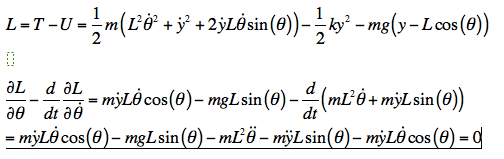

Hello,
I have copied over my work, and I still see the term canceling out. I have collected the calculations in a screen shot so that you can see them and see if one of us is doing it incorrectly. See in the attachment, on the last line, the first and last terms.
OK, Good. It was my mistake. I did overlook a term. Thanks for setting me straight. Hope I didn't cause you too much grief with my oversight.
No problem. Thanks for the help.
