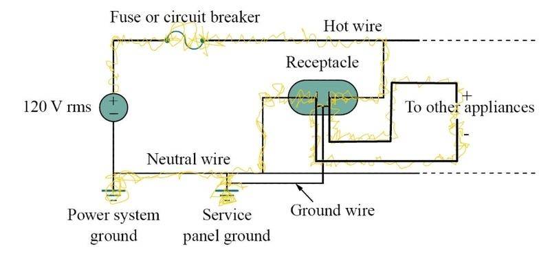

  • #36
Using ur analogy the ground wire is just a short (but there is some resistance due to the ground wire).
But the actual EARTH which the path of the ground wire takes the current to, is not a load? The Earth doesn't have any resistance in the circuit?I cannot model a circuit with a ground like this:

  • #38
It does have a resistance (when measured from one point to another), it just doesn't matter, because everything is connected at one point with metal conductors. The ground wire does not travel through earth, it travels TO earth. There might be a high resistance between what you're standing on and the point at which the ground electrode is implanted. This also (sometimes) keeps you from getting killed if you happen to touch the live wire. Or not, if you happen to be near the Earth electrode, or what you're standing on happens to be metal and connected close to where the electrode is implanted, or just has the same potential, (which is why, as another poster has said, you should never touch the bare metal of a live wire--or any wire, just in case something's been miswired).
Your diagram is incorrect in that the ground wire doesn't have a big resistor right before ground (the three-line thing). To model the above, you'd have a stick man figure (representing you) on top of a resistor which connects to the ground point (as mgb_phys says above). If you touch the live wire, you put yourself in parallel with the other two 'resistors' I've mentioned. Unfortunately, this 'resistor' you stand on top of varies, and might very well be low (low enough to put the 40 mA(?) or so through your heart required to cause your heart to start beating funny, or stop beating all together).

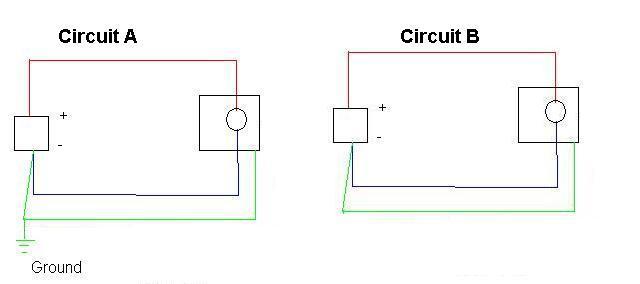

  • #39
Ok thank you
can someone quickly take a look at the following attachment, which diagram is right, looking at the ARROWS which represent the current.My questions:
if DIAGRAM 1 is correct what causes so much current to go into the Earth. why does the Earth take so much current rather than the ground wire back to the negative terminal.if DIAGRAM 2 is correct, which I sort of hope is not correct, why is there no current in the ground wire which is going back to the neutral wire (connected to the negative terminal).

  • #40
The Earth does have a resistance, the risk is that you don't know how big it is. If you are standing on dry rock there might be enough resistance that the current through you and the (planet)Earth might be low enough to be safe. But it may also be very low if the ground is wet.
You try to design the (wire)earth to be low resistance so that most of the current flows through that instead of through you - if the case of the instrument becomes 'live'.
See the attached picture, what would happen if the red wire, and you, touched the case?
edit - the answer to your question. current only flows through the Earth if there is a fault and the live wire touches the case. Normaly this isn't the case. Both diagrams are correct but in practice the short circuit means no current floaws through the load (because the case is lower resistance) and so a very high current is drawn and the fuse will blow.

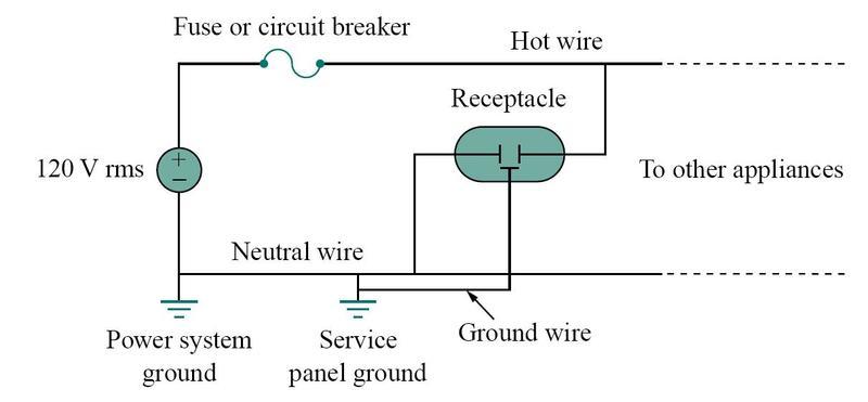

Here is a Schematic...Please correct it.

Redbelly98 said:
salman123 & XPTPCREWX,
Think about what would happen in a house where Hot and Neutral are erroneously wired backwards. Do you really want that box connected to "Neutral"?
HENCE...
If Neutral is connected to Ground...THEN IT IS A SHORT CIRCUIT...period...
Why doesn't this trip the breaker when ground is in fact connected to the Neutral Bar?

Look at your figure from post #48.
The fact that neutral and ground are shorted together does not cause high current to flow through the fuse, because that current must still flow through the load resistance. (Fuse and load are in series.)
However, shorting hot and ground together (when neutral is already shorted to ground) would cause high current to flow through the fuse (or breaker), since then you are bypassing the load resistance in that case.

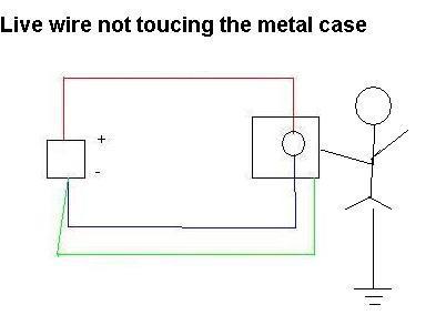

  • #55
Hmm, Without the livewire touching the metal case the ground wire does not create a complete circuit and as a result no current flows through it. As soon as the livewire touches the metal case for any reason, the ground wire will start to carry current.
What i am a little confused about is the purpose have the actual Earth. Why is the connection to Earth? Why not just make a complete short?
Check Image...

  • #56
That is said to be a 'floating' circuit and for a battery powered circuit it wouldn't matter.
But if it is floating then the + and - can be any voltage above 0 there is nothing to make the - terminal the same voltage as the Earth.
So suppose the + was at 1100V and the - was at 1000V, the circuit would work fine. But if you touched the case, even without any fault, the case would be at 1000V above ground and your feet would be connected to 0V so you would provide a path for the current to flow through!
The reason the Earth is used as a reference is that it is also the thing you are msot likely to be touching ! And you can be sure that the Earth in your house is at the same voltage as the Earth at the power station.

isly ilwott said:
You are not talking to "amatures". You simply misunderstand what the supposed amateurs are saying.
I'll get out my paint prushes and send you a picture that you may be able to understand.
I think you are the one who simply misundertands.
isly ilwott said:
The neutral is grounded at the main panelboard. Any potential at the load in of the neutral wire will be due to voltage drop from one end of the neutral to the other, caused by the resistance of the neutral conductor. It will be in the range of 5 volts or less, depending on the length of the circuit. It will not be 120 volts...or anywhere near that high.
who is arguing otherwise?
I am asking you...
What is stopping Neutral from "equalizing" (shorting) its voltage with Ground and transferring its current into Ground?
Ground has a lower potential difference, and offers the path of least resistance.

XPTPCREWX said:
Regardless of the voltage drop, however miniscule the voltage in neutral may be in reference to ground...the current in neutral is the same as the HOT leg supplied to the load.
Thus: neutral is HOT.
If no one understands this they are Amatures.
Ask anybody in the field (power engineers and/or electricians) and the HOT wire (slang for the LIVE wire) is the wire which carries the high potential relative to ground (amplitude-wise, as it's AC). It has nothing to do with the current it's carrying. As the voltage is what drives current through something, you're usually safe grabbing neutral wires (assuming the path from you to ground is sufficiently high resistance that you don't start looking like a convenient path to go through to get to ground).
XPTPCREWX said:
With that said...
If Neutral carries the same current at the Load end of the Hot wire.
Nothing, this is what happens. If you were to crack open your breaker box, you'd see that the neutral bus bar is connected to ground (at only one point, usually via a bolt--this point is code in most locales!) Since you sound like a show-me kinda guy, KILL THE MAIN BREAKER BEFORE STARTING TO REMOVE THE FRONT PANEL--NO SHORTCUTS! Or, take a look about half-way down on this page (breaker panel anatomy):
http://www.hammerzone.com/archives/elect/panel/breaker/install.htm
XPTPCREWX said:
first off you drawings are wrong. and you are basing all your questions on a false basis.
ground will reduce shock/electrocution/arc blast/ and further damage to the equipment and operator, by creating a lower path of resistance and lower potential difference than anything or anyone around it.
what i think everyone need to focus on answering is HOW this is wired. Every drawing i have seen is a short circuit between HOT and NEUTRAL and GROUND.
Yes, there's a short between neutral and ground. I have never seen a short (i.e. non-load) between hot and these, however.
