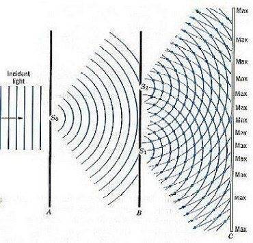

While I think about this question some more, here is a diagram for you to consider. Perhaps it will help you to conceptualize the situation from another perspective.
The reason I asked, "... why do you ask?", is because knowing the reason for the question could be helpful.
