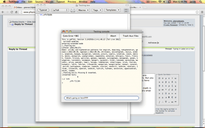

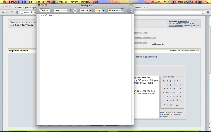

I just downloaded something and it looks like this. Do you know how I can do some math in this? I tried entering some commands that I learned and pressed "typeset", but here's what came up:

You can try this small example:
\documentclass{article}
\begin{document}
What's the difference between
$E=mc^2$ and $c=\sqrt{\frac{E}{m}}$?
\end{document}
and then press the "Typeset" button just underneath your "traffic lights". You'll find lots of information on how to use TeX from TUG (www.tug.org).
P.S.: The "documentclass" line is part of this example. I don't know how to get it to stay in that box though.

OK, that worked. Can you explain to me why it didn't work until I added the \documentclass{article} and the \begin/end{document}? Also, is there a preferred document class for writing math equations?
Nov26-12, 06:38 PM   #6
Your program is switched to "LaTeX" mode (as you can see next to the "Typeset" button). LaTeX provides easier formatting of documents, things like tables of contents, inserting figures etc. than PlainTeX. But LaTeX also demands some framework code, the "documentclass" and a "begin-end{document}" pair.
If you just want to typeset a formula, switch to "TeX" a.k.a. "PlainTeX" (next to the "Typeset" button) and try this:
Here is a nice equation:
$\sqrt{12+\sqrt{12+\sqrt{12+\ldots}}} = 4$.
Care to prove this?
\bye
and click "Typeset".
