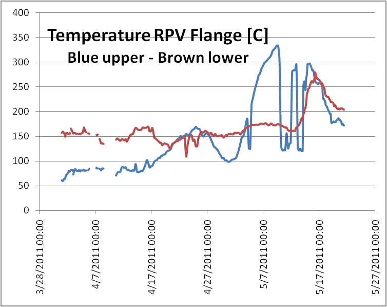

Samy24 said:
Looks like they have manged it!
http://www.tepco.co.jp/nu/fukushima-np/f1/images/032_1F3_05100600.pdf
no way, 6 hours and 170C difference ?? strange, or it was sensor error...
Not all readings are down that much. But you are correct the mass is >100t and there sould be a delay in the temperature change.
Maybe at the measurement point with the biggest drop there was no water before. After the change of the injection path there is now water at that place.
Also if cold water would hit 300C metal there should be much steam, but there wasnt on live webcam
