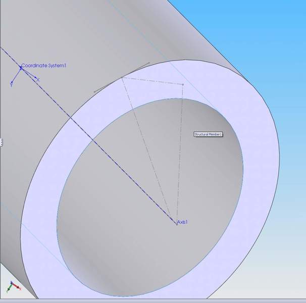

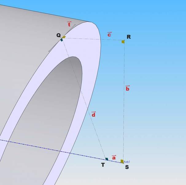

I've been scratching my head over this one. I'm trying to find a system of equations to solve for points R and S. The known parameters are: Point Q, tangent vector t and the axis vector a.
The following vectors are perpendicular to each other:
a,d
a,b
b,c
c,t
d,t
The other known parameter is that vector c has a magnitude of 0.0625. This creates a quadrilateral that is skew, with vector c and a being at an angle to each other and pulling the sides out of plane.
I'm trying to find the mathematical way of solving this across a number of points. SolidWorks can find one valid answer for the sample (and fully defines the topology) but I cannot get a system of equations to solve to match in Mathcad.
Any method would be appreciated? I'm trying to get it so that I don't have to rely on the SolidWorks sketch engine to reduce computation times.

Hey athuss and welcome to the forums.
So looking at your diagram, here is what we know:
Q + c = R
R + b = S
T + a = S
Q + d = T
tunit x cunit = dunit
The approach I am going to take is to use the tangent vector to get the plane that contains the points Q, R, and T as well as the vectors c and d.
We know the plane equation since we have a point on the plane Q and our normal vector t. If we use n to be the normalized vector for t we get our plane equation to be n . (r - Q) = 0.
Now from this point we need to establish how the direction of a affects the direction of either c or d directly.
Now we know that a and c are parallel since a,b orthogonal and b,c orthogonal which means ahat = chat. But because we know this, it means that we can calculate dhat by calculating dhat = that x chat where the hat vectors are normalized.
Now we have the vector c since we have its magnitude so we get c = chat*||c||.
From this we have R by using R = Q + c. So that's R down.
Please tell if I've screwed up anywhere with regards to assumptions.

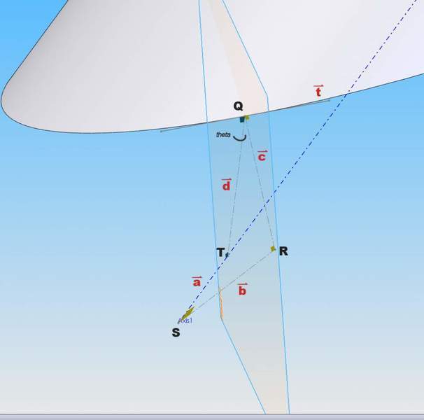

Hello chiro, thanks for the help.
I worked through your reply and I think that there is one assumption that isn't true. That is:
tunit and cunit are perpendicular, as are tunit and dunit, but cunit and dunit are not.
This means that a and c are not parallel and the vector c is still unknown.
I've attached another view to show the skew of the quadrilateral. I think there is enough information to solve this but I haven't yet found it.
