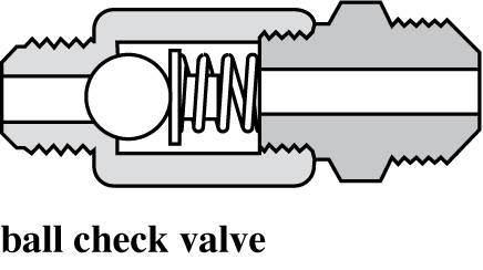

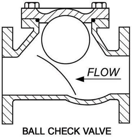

These are the two styles of check valves typically used for PD pumps. A "ball" pump is a diaphragm pump which uses ball checks as the method of preventing backflow. A "Flap" or "flapper" pump uses a "flap" valve, similar to a swing check.
The ball valve has a circular opening in which a sphere sits and creates a seal, when water flows in the correct direction, it flows through the orifice, pushing the ball out of the seat, around the ball and into the next chamber. As flow stops (as most diaphragm pumps have at least some degree of pulsing due to their method of operation) and pressure in the pumping chamber is reduced, the water would tend to flow backward. This re-seats the ball in the orifice and disallows backflow. Like this:
